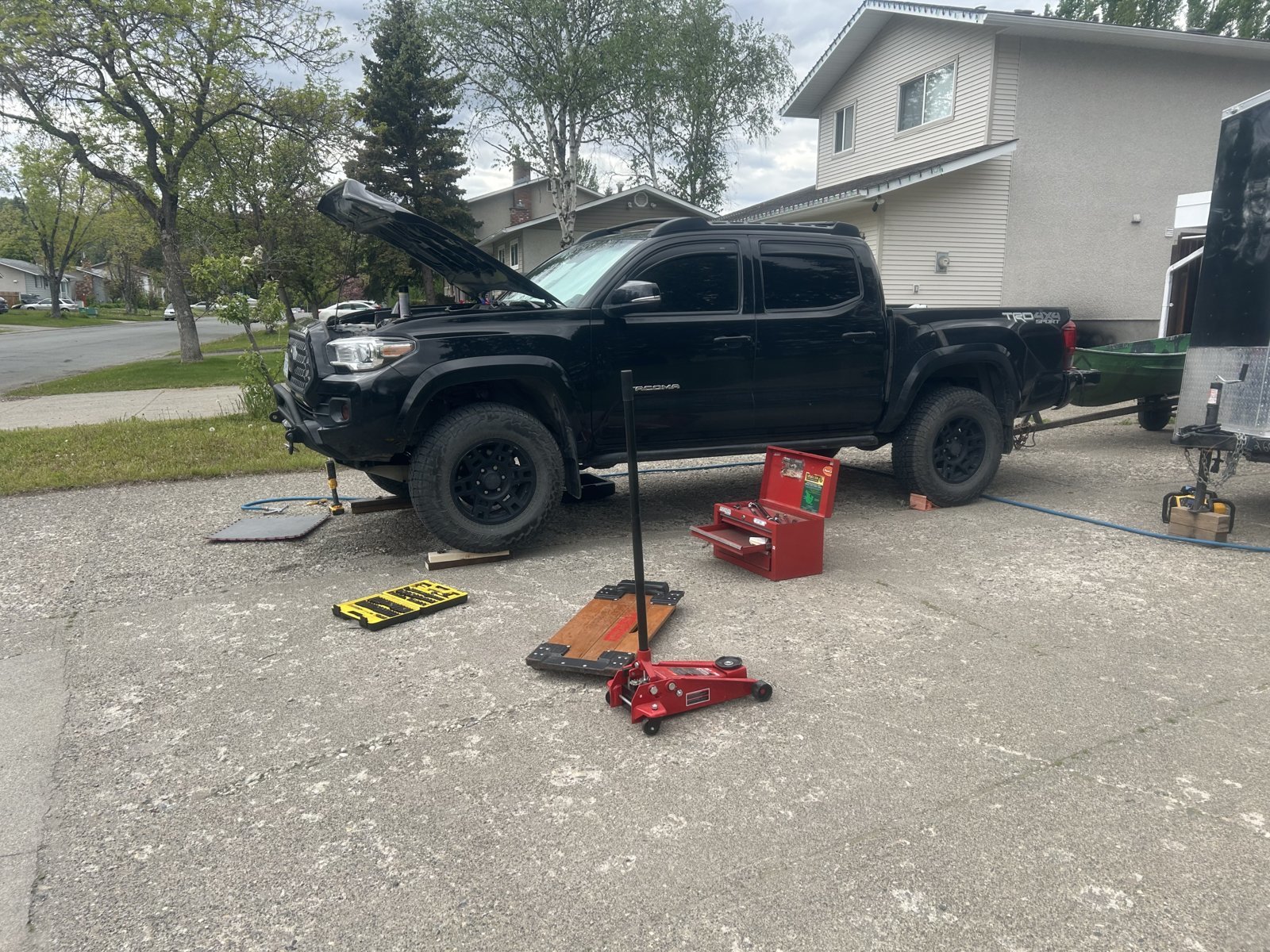

    Just curious, why’d you remove the skid? Didn’t do that for mine, just did this a few weeks to a month ago. 5/16” hose on the two drain points gets it all. I did drip a bit from the radiator onto the skid but nothing I couldn’t get with some paper towels after.

    Now that you ask me, I guess I didn’t have to. Hah
    I watched that^ video and saw dude removing his “splash guard”.
    Anyway, gave me a chance to have a look underneath the engine compartment.
