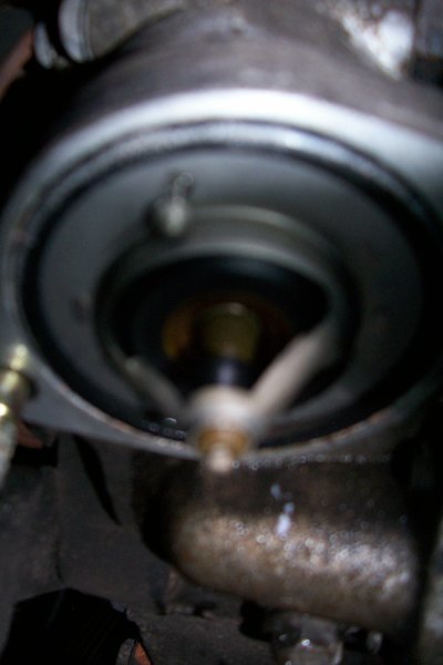

    3. Remove the skid plate from under the vehicle so you can access the radiator drain valve which is located under the radiator on the passenger side. It's a little plastic valve with a spout. Put a bucket / oil pan under the spout and slowly loosen the valve (you may need pliers to turn it) until coolant streams out.

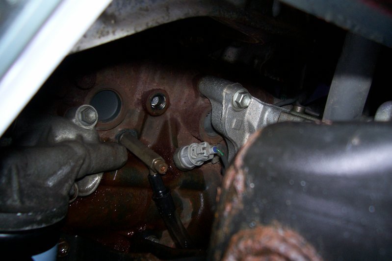

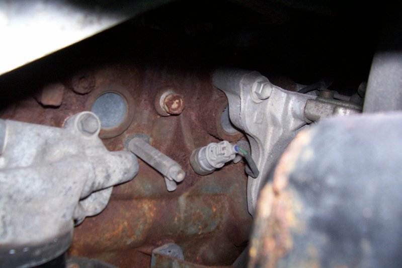

    4. Locate the engine block drain valve located behind the passengers side tire. You'll have to remove the rubber skirt hiding it if you have one. It's pretty far back and hard to reach, but you should be able to get your hand in there.

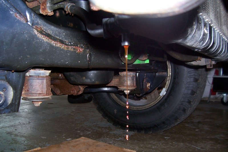

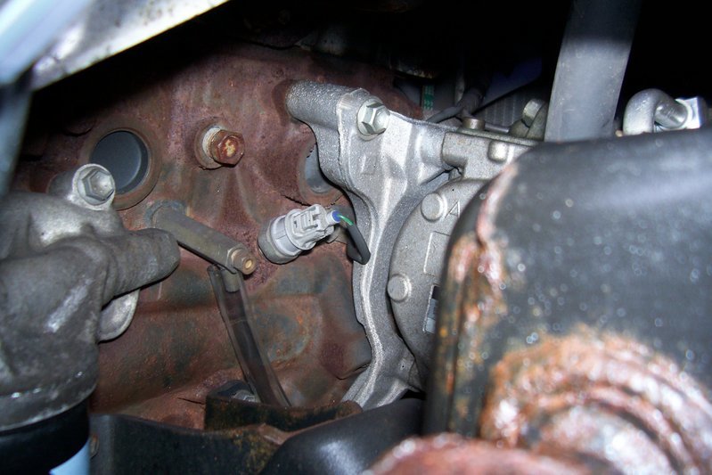

    5. Place one end of the 1/4" tubing over the nipple that's under the drain nut. Place your 14mm socket , extensions, and U-joint adapter on the drain nut located directly above the nipple.
    6. Place the other end of the tubing into your drain bucket. Loosen the drain nut to drain the coolant from the engine block. Keep the socket wrench in here so you don't have to fish around to get it in place again later.
    7. let everything drain completely, then tighten both the valves.

    I have a 1998 3.4L engine and my block drain is located on the passenger side about midway back from the engine's front. It has a nut that one can supposedly turn to let the coolant in the block drain, but only a hole below the nut for the coolant to drain out. No way to attach a tube or hose. I didn't look, but I don't think my engine has any coolant drain valve near the rear as your photo shows. :(

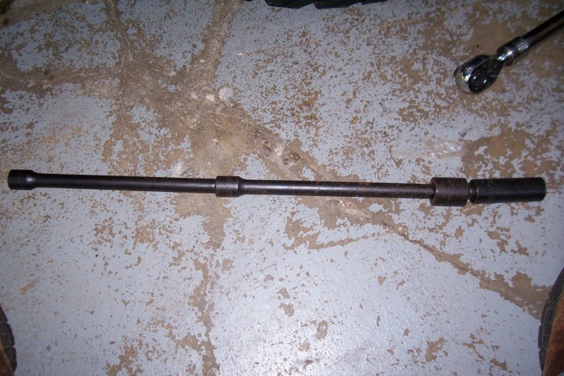

    Thanks for the guide! It helped me a lot. Did this over labor day weekend. I took a few pics also. I have an 01 2.7. All parts came from camelback except coolant. Got it from local dealer for 21$/gallon. I had 2 gallons on hand but only needed 1 along with 1 gallon of distilled for final fill. I think manual says 8.7qts capacity for 4x4 4cyl auto. I originally drained out almost 5qts from radiator and the overflow bottle. Then located the block drain. To get to that I needed a 17mm socket and series of extensions and universal joint on the end. I had a clear tube hooked to the drain but didn't need it. I eased the block drain out and coolant poured out of it instead of the little drain valve. I got almost 3qts out of it. Then tightened and filled with distilled and ran till it was warm with a/c and heat on. Drained all that out then filled with long life coolant and distilled. I measured exactly 3qts of coolant and 3qts of distilled in radiator then added 1/2qt coolant and 1/2qt distilled to the overflow bottle to the full line. I have a tester but it should put me real close to a 50/50 mix. Not sure when coolant was changed last as I got the truck in may but didn't see any rust while draining or any in hoses or thermostat. I also changed upper and lower hoses and thermostat and new radiator cap. On my truck the jiggle valve was indeed at the 12 o'clock position so I put the new one in like that. Again thanks for all the pics and tutorials on here :thumbsup:
    Truck 007.jpg Truck and cookout sept 2016 005.jpg Truck and cookout sept 2016 006.jpg Truck and cookout sept 2016 009.jpg Truck and cookout sept 2016 012.jpg Truck and cookout sept 2016 011.jpg Truck 009.jpg

    Second, the engine block drain plug on my 95 does not seem to have a petcock. I'm gonna hope that a funnel with attached fuel line / garden hose will be enough to keep the coolant from running all over me. I found a picture on toyota-4runner.org showing what my drain plug looks like (no petcock or hose attachment) Theirs is a 97 4runner. This just looks messy and i'm trying to avoid it. Anyone else drain their block sans petcock?

    As far as the petcock goes, mine had a little tube extension below the actual block drain bolt. You can see it in my pic but mine is a 01. Once I loosened the bolt coolant poured out of it instead of the little tube. I just put my drain pan underneath to catch the coolant. I ended up getting about 7.5qts to drain from radiator+block. I also changed both hoses which had a little bit in them and thermostat. I also emptied out the overflow reservoir as well. Long story short your 1 gallon+1 gallon should be plenty especially if you don't drain the block. I cant comment on the mixing of coolants, I stuck with the red long life for peace of mind but again I have an 01. I know other people have used them though. I think with 2000 or before most just use green coolant, the change didn't happen till 2001 I believe.
