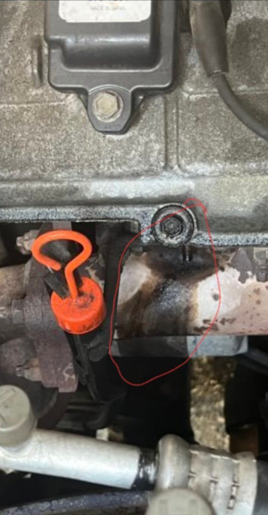

    but just refilled with coolant, on an incline and burping the hose. Still air bubbles coming out- but that steam is back in a very pinpointed spot.
    Planning to take it to a mechanic Monday- but until then could anyone tell me what part is steaming- at least then I can have an idea of what’s happening before taking it in.
    the pic included is of the area- and looks like it’s the metal hose just behind the transmission dipstick- just not sure what that’s called.

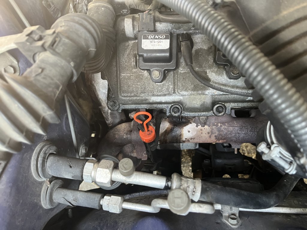

    If your talking about this, that's an oil leak from the valve cover gasket that's dripping onto the exhaust manifold and no doubt it's burning off and smoking.
    Relatively easy repair, just needs new valve cover gaskets.

    I was referring to that- thank you! That would track cause looks like my oil went down quicker than usual.

    I mean it doesn't look bad enough that you would notice a drop in oil level but I bet if you look at the other side it's gona be leaking as well.

    Not a terrible job, do note that the upper intake manifold needs to be removed to do the driver's side.
