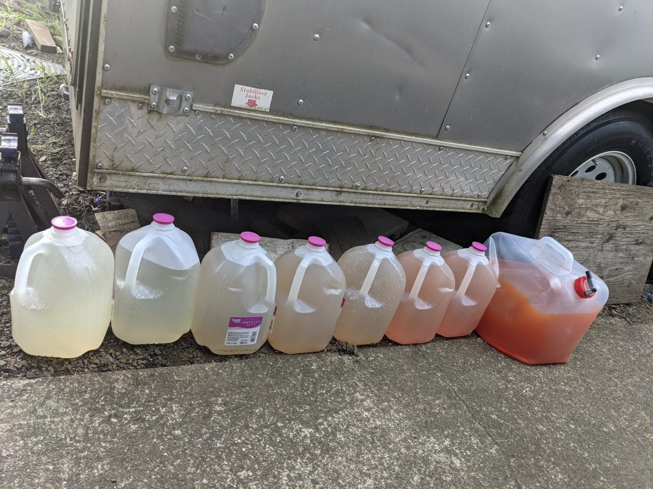

    I had to do a solid two day flush on my 1st gen after swapping out the water pump/timing belt. My son drives this truck now and when the water pump started leaking good, he was a few hours from home and didn't have access to the Asian red stuff, so he topped off with the generic green stuff to get it home.
    Lots of distilled water ran to full head up, drained, refilled and repeated again and again until the drained distilled water was almost drinkably clear.
    I had a lot of gallon jugs of antifreeze/distilled water to take to the transfer station to properly dispose of it.
    This pic is just one gallon from each purge. The bigger jug of red/green mixture was the stuff he drove home with.

    Can't you just stick a garden hose where the thermostat opening is and run it until water runs clear out the lower hose/opening. Then quick flush with a few gallons of distilled water and fill?
    I'm running stock red and no plans to change because I'm lazy, but I have seen blocks flushed like this before. If I had green I wouldn't switch it back for the same reason.

    Did you drain the engine block after flushing or just the radiator? I’m only asking because I can’t find the damn drain plug on my 5vz-fe engine.

    I just used one of those funnel things that attach to a radiator cap thingy, and fill the rig up with distilled water until the funnel is half full so I could monitor the color as ot changed during a full heatup cycle.
    I had the front of the truck up on ramps to facilitate a good burp each time. It also helped to slide a piece of cardboard down in front of the radiator to help it fully heat up.
