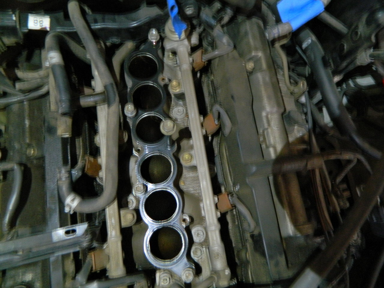

    @ Dirty Pool--
    As it so happens, my intake is presently off, for valve cover gasket replacement. Here's where it stands at the moment:

    Well, that pic is not as nice as I'd hoped, but I don't see anything white.

    You have your upper intake off. In the pic he posted showing the coolant tube that is lower intake off, but u have to take the timing belt off to get the lower off.

    Ahh, I see.

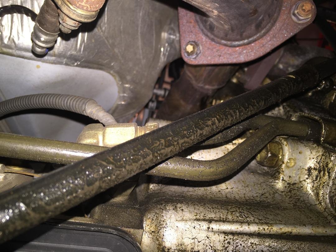

    Update: I just now noticed that I do now have a leak visible on the floor, in line with the rear of the engine. There's probably several tablespoons leaked there.
    I photographed it with my phone. I'll upload it when I can.
  18. Dec 24, 2017 at 7:57 AM
    #18
    zach141b
    zach141b [OP] Well-Known Member
    May 11, 2014
    #129576
    398
    Zach
    Louisiana
    2001, double cab, 4WD, 3.4L Tacoma
    Okay, here we go. For this photo, I'm lying on my back under approximately the passenger floorboard, looking up. (So, sorry for the orientation.)
    A significant drip from the rear of the engine can definitely be seen... How to attack it??

    When my coolant tube that runs under the intake manifold leaked, it showed up on the back, passenger side bell housing. I followed it up to the back of the engine to the cover between the cylinder heads. I first thought it was a HG leak.

    So was your fix as mentioned earlier, resealing the front end of that tube?
