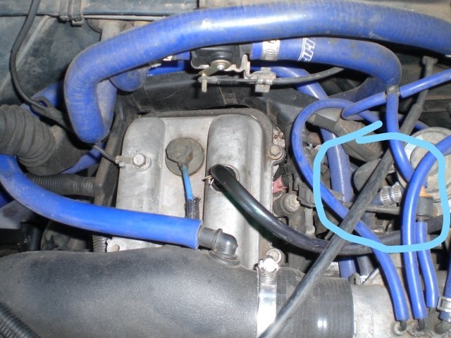

    ...you can use extra line and loop it out futher.....even completely reroute like I did the IAC air feed......decongest whats under the throttle body a little....
    I understand yours is a little different....but same strategy....

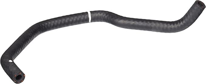

    Amazon.com: TOYOTA 16267-75010 Engine Coolant Bypass Hose : Automotive
