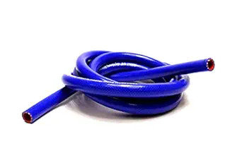

    I've run HPS silicone hoses for a few years. After years and hundreds of dirt miles later they are still in great shape, no leaks, no dry rot and the red color still looks cool!
