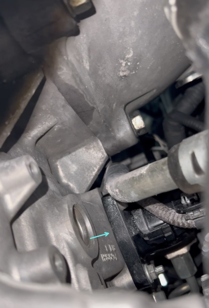

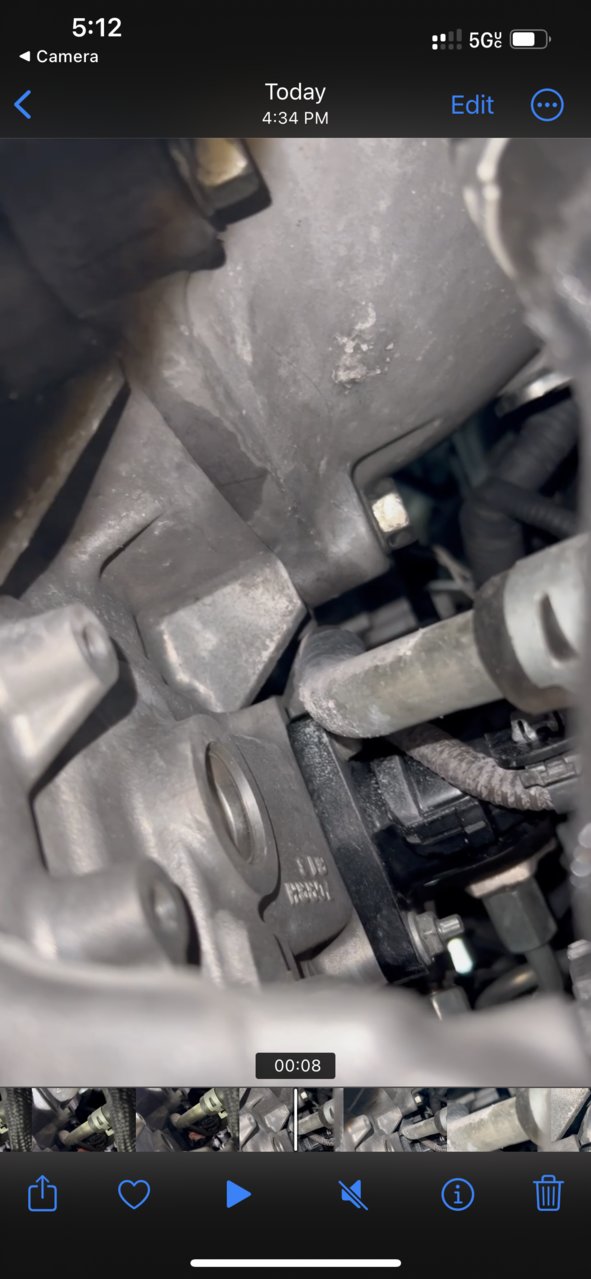

    Update: So Im never one to really complain at the dealer, since they failed to tell me the part was in prior to dropping the vehicle off. They had to keep my truck one extra day.
    I politely went back and forth w the tech advisor, basically told him I didnt want to go over his position and talk to a higher up. I mentioned at my job if I was to pencil whip anything ie: drugs, gear, etc. people could die.
    (Ended up getting a free oil change, atf, & coolant flush lol)
    Tried to take a photo of the replacement part. I’ll do it again this week when weather permits.

    Great to hear the got it replaced. Sucks about the miscommunication. Did they offer any details on how they fixed it?

    They ended up dropping the transmission.
    Total was $1,357.50 :spending:
