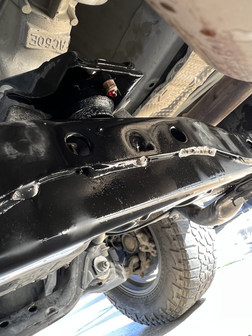

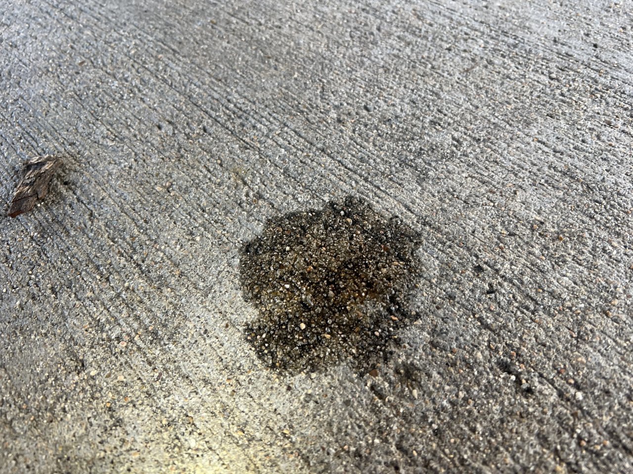

    A little guidance: at work this morning. Stuck here 24hrs…
    I noticed a small oil-ish spot under my vehicle when the sun came out finally.
    Emailed Toyota dealer about it w photos just so its documented.
    Should I wash off what appears to be ATF fluid and monitor? Or take this b**** back and request another service with post documentation.

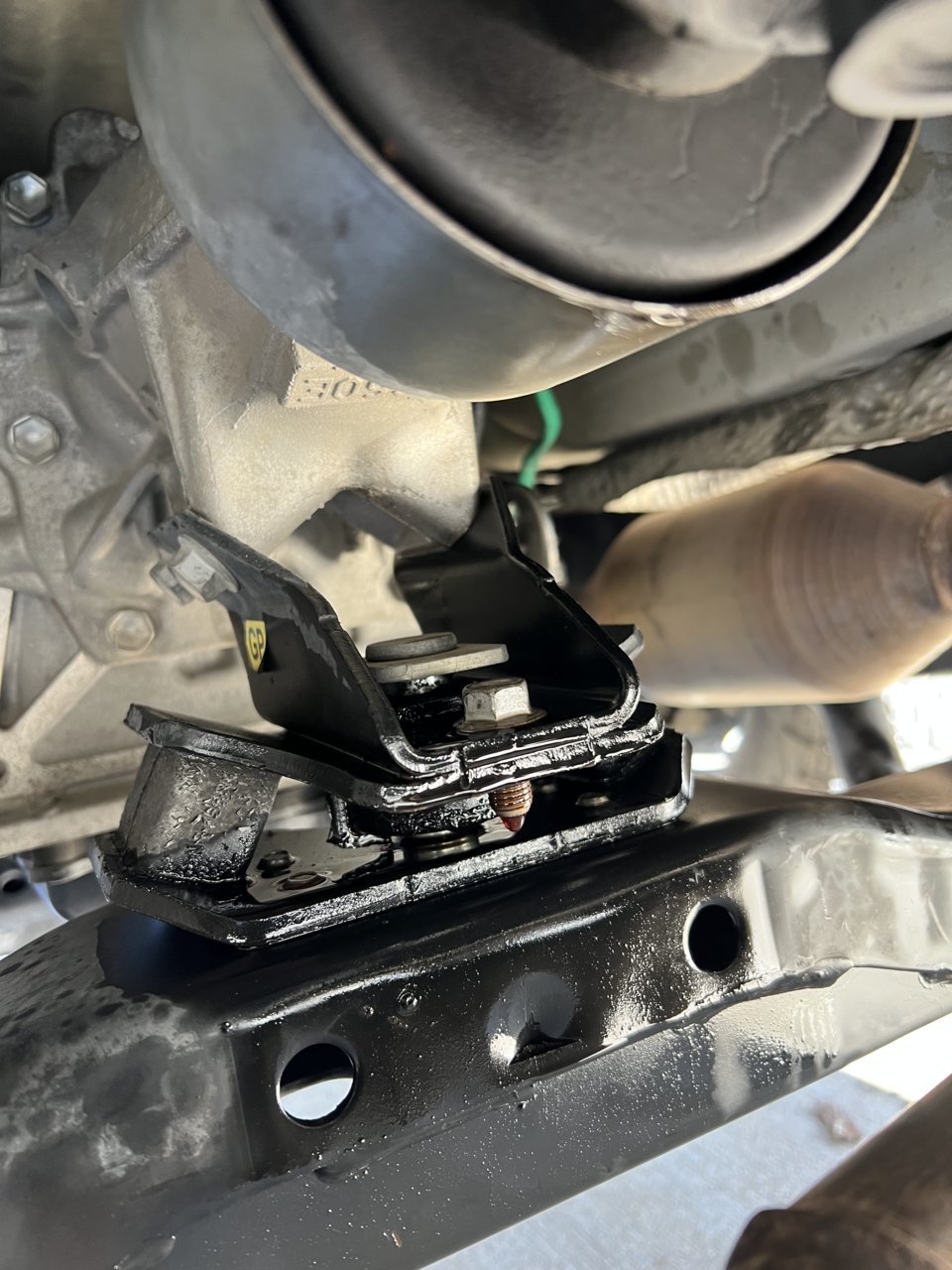

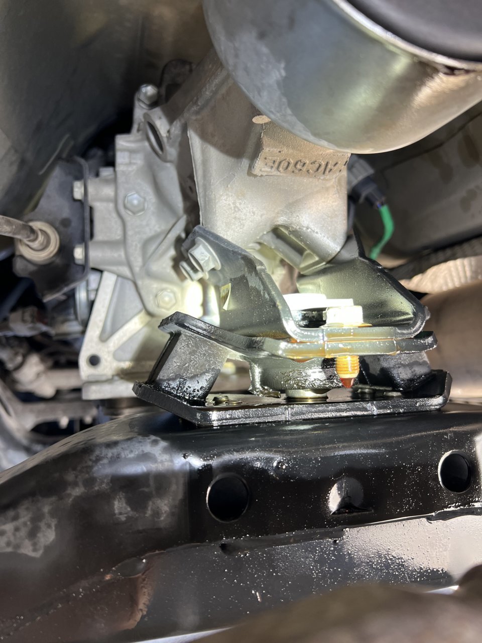

    Well that's kinda BS if it is a real leak.
    That said, I wonder if it isn't penetrating oil that they sprayed on? They have to remove that crossmember to pull the transmission. I do not see fluid up any higher than the support fasteners?

    I am hopeful for you, esp after that extravagant bill. It does have the color of ATF, but some penetrating oils are the same color.

    Sorry man, looks like a rear seal to me, I hope I'm wrong. Either they did not replace it with a new one when they pulled out the propeller shaft, as they should have and addressed any burs or groves that may have been left by the old seal lip, or they damaged it during installation.
    I would go over the RO and look at the parts list and see if they list one for the rear and the front, it’s always best practice to replace any seal and address any shaft seal groves or marks.

    So we been busy at work , responding to calls etc. & I didnt have enough time to thoroughly inspect, came back from a run, I find that the drain plug wasn’t even placed. FML
    Called head guy at the dealer/service dept.
    They are now towing my truck back which is less than 3 miles away from my fire station. I asked him to keep the truck today and Id be there in the morning after my 24hr shift. Also requested a complete inspection with documentation as I really dont have any faith in the service that was provided.

    Yeah. You blew up the theory, which is fine.
    Hopefully you get sorted out quickly and properly. At least you know that there will be no charges for you.
