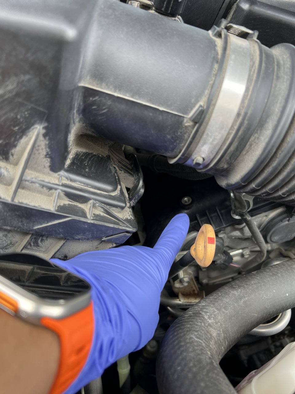

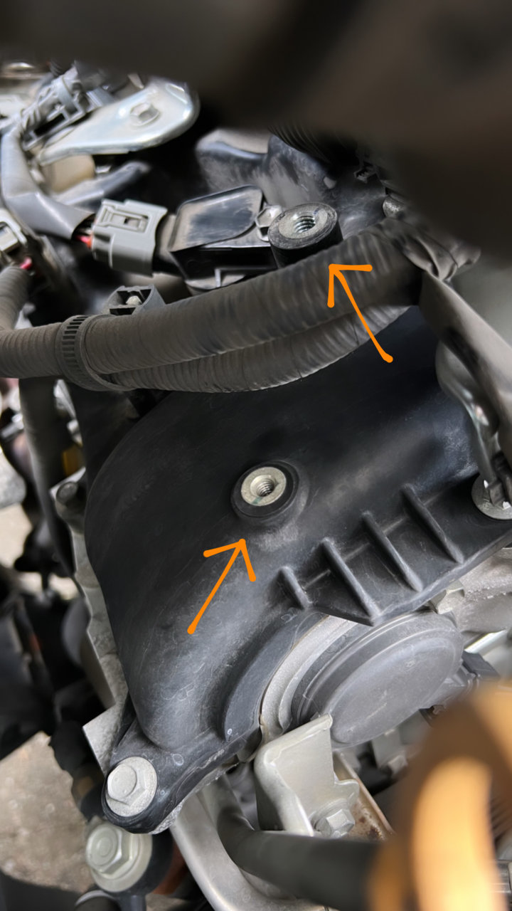

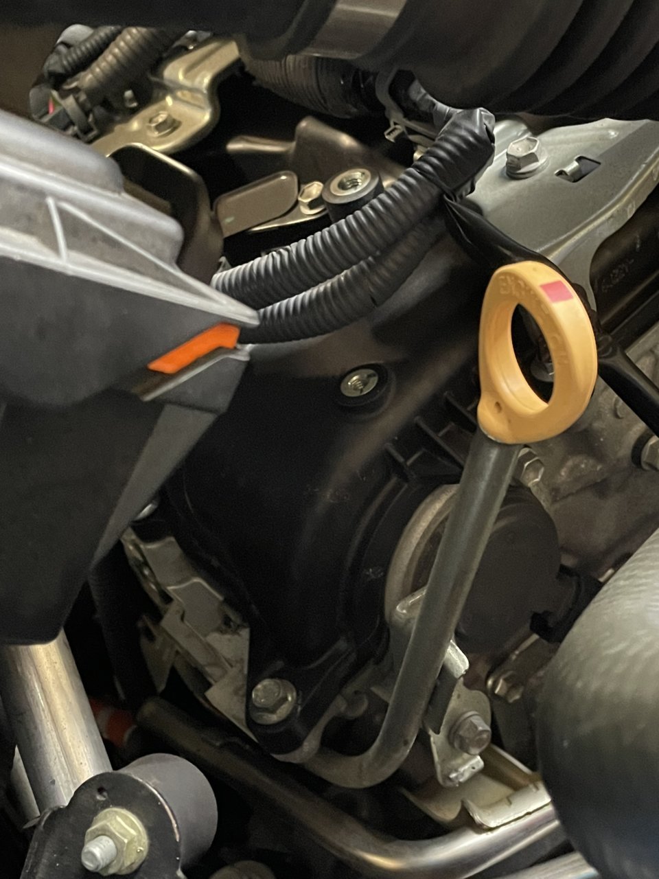

    Quick question to anyone that can chime in. I never noticed this, but is my cover supposed to have bolts here and or a bracket??

    There are lots of extra, unused inserts. I don't think that one is a worry.
    I believe that blue mark was a factory check that nothing was supposed to be installed there.

    Unless someone beats me to it, I’ll let you know in 8.5 hrs. I’m almost done with my 36 hr shift

    I don't see anything that may be a concern, my SR5 is the same. The valve covers maybe used on other 3.5l applications where they may attach a bracket and such.

    You’re good
    Mines the same
