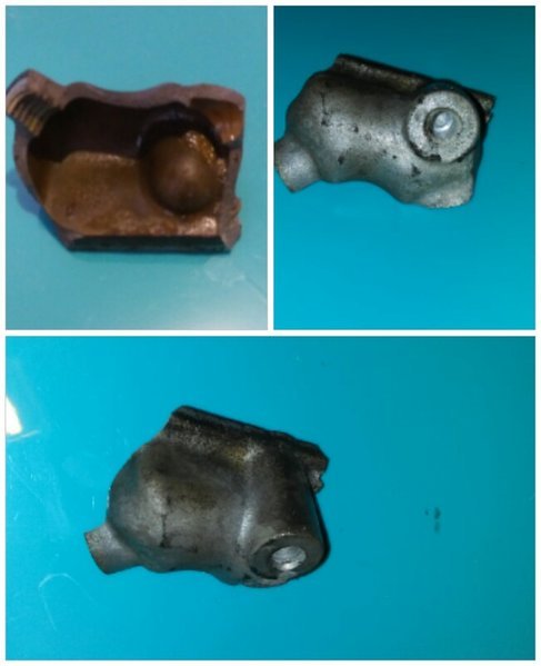

    Anyone know what part this is? It came from the heating switch area.
    Its been below freezing here in ga. My truck don't do ice Lol!!

    I honestly think that's a piece of something that broke..

    Yea, but what? Help a lady out :)

    Please tell me you weren't running straight water. That's either from the block or the head.
  7. Jan 9, 2017 at 1:17 PM

    :angrygirl:yes unfortunately

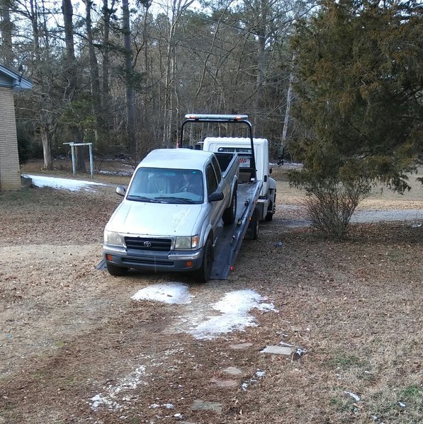

    Ok I think the tow truck is here. Hold on!!

    I think the engine temperature sensor housing split. It's the part on the back of the head
    dmarion24[OP] and bretts like this.

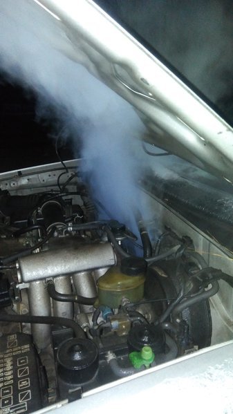

    ^ seems to be where the steam is coming from as well. Good call 98

    2000 pre runner
