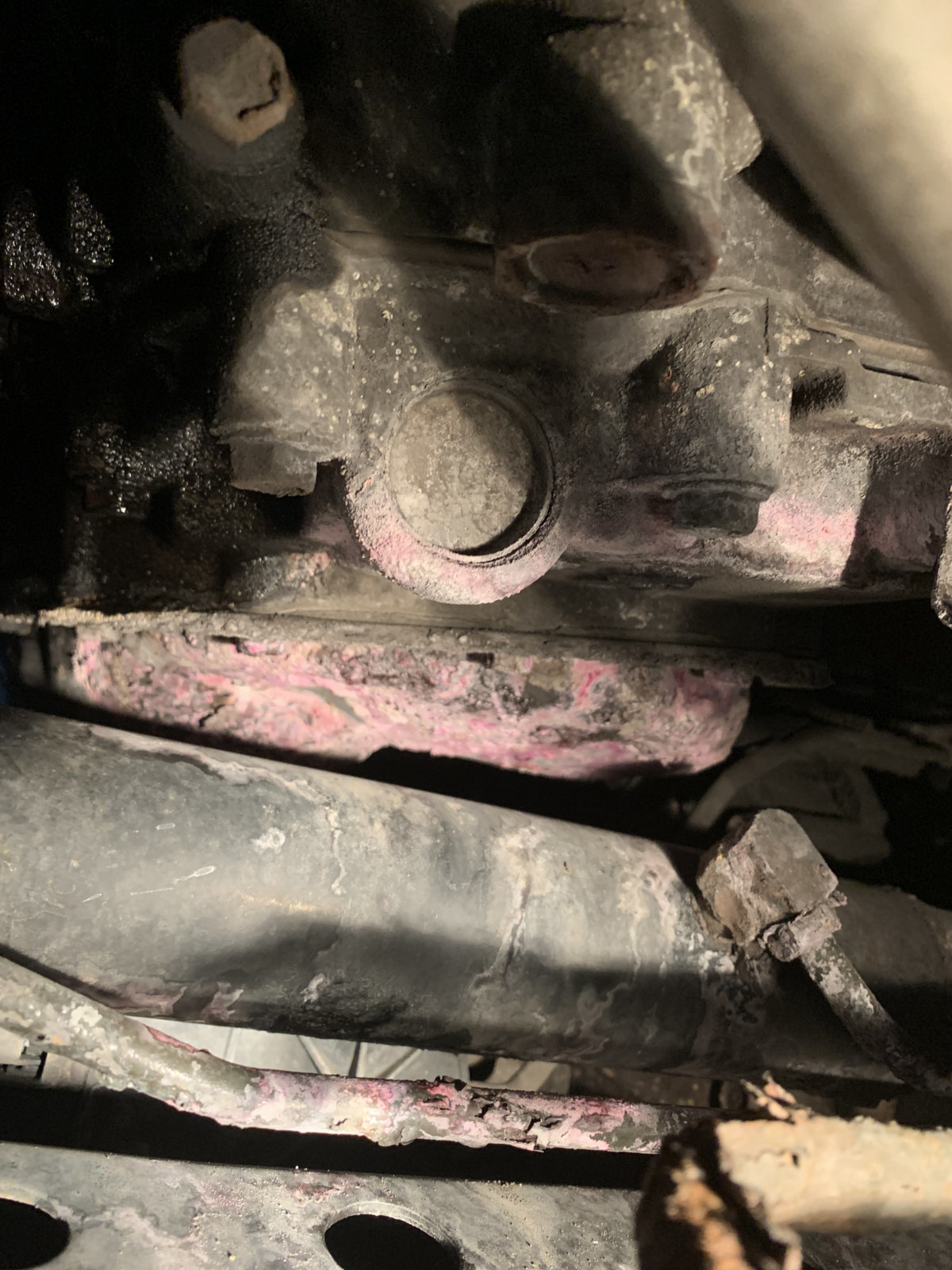

    Hello. I have an 05 2.7L, 5 speed with 152K miles. I have developed a coolant leak. I have read about the plastic coolant pipe. I have included a couple pics. One of the front end of the pipe near the thermostat housing and the other at the bottom of the engine. Does it look like I need to replace the pipe?IMG_0933.HEIC.jpg IMG_0936.HEIC.jpg

    Yea looks like the classic coolant bypass pipe leak.
    I'd get it done soon, it looks like it's getting pretty bad.

    Yes it needs replacement.
    Do it before it lets go completely.
