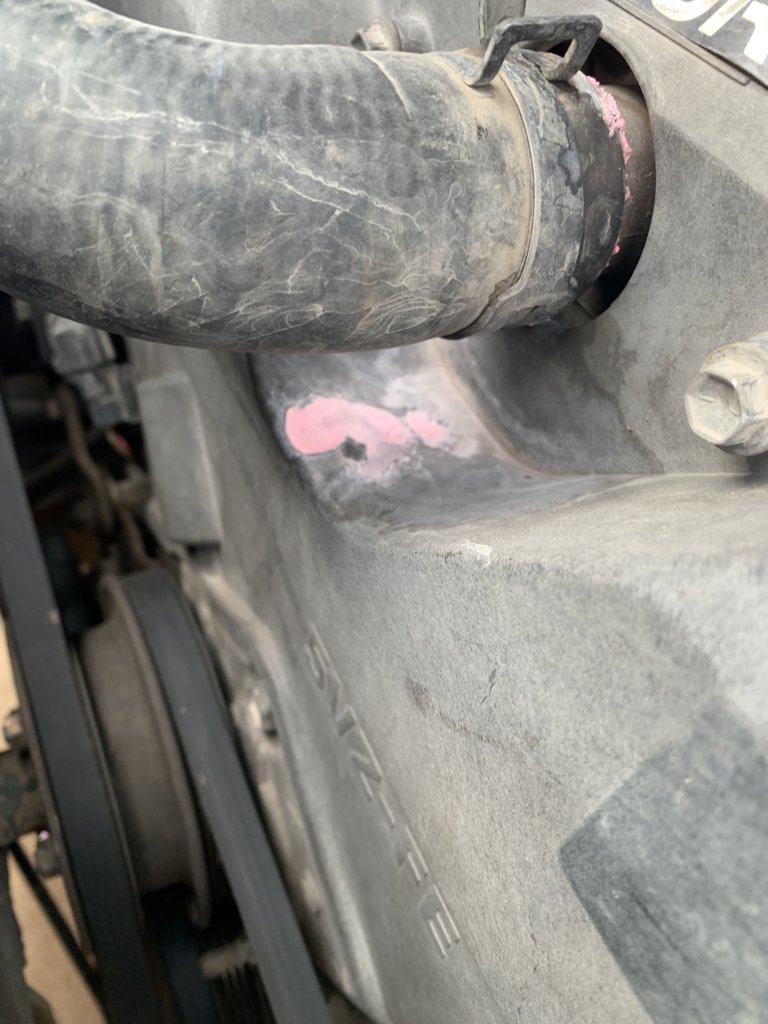

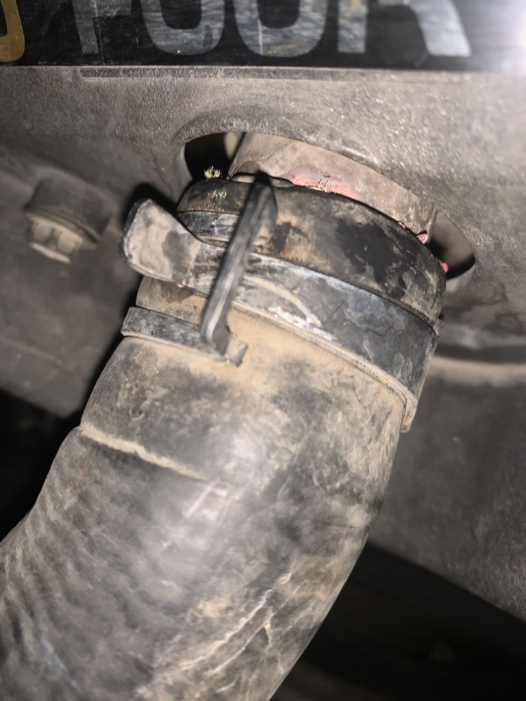

    Hi, ya'll just curious what ya'll would do about this issue. I've been going into my engine bay pretty often but yesterday I just noticed this dried coolant around the edge of the engine inlet upper coolant hose and some dried on the plastic cover. I did the water pump a few months back and removed and re-installed this hose and yesterday I saw that it looks like the metal clip in that section is looser than its previous resting spot.
    Curious what the urgency is and what ya'll would do to fix this problem.

    You need to squeeze the camp and slide it back then shove the hose on farther and then slide the clamp back to its original position.
    If the leak persist after this replace upper radiator hose. Don’t try and squeeze it with a band clamp. JMHO
    The upper radiator hose should be pushed all the way until it’s through the plastic TB cover.

    that hose is on all the way to where it should be ... there is just a massive amount of builtup crusties on the metal under the hose that a razor blade carefully should scrape it all off top to bottom...this is how i repaired mine many years ago
    there is a little ridge on the metal that the hose snugs up to iirc without checking my taco out
    do you see that little lip in the OP picture what i am talking about?

    Looks like a little seepage, not a big deal but I would replace both upper and lower hoses before it becomes one

    No, there is a metal tab you can see right there in the picture that stops the hose from going on any further. He can clean it up with some WD-40 after draining some coolant into a clean bucket and removing the hose and try reinstalling with slightly more pressure. Then replace the hose if it’s continuing to do that. I’ve got a little seepage there even with a new hose and a screw hose clamp after 3-4 years.

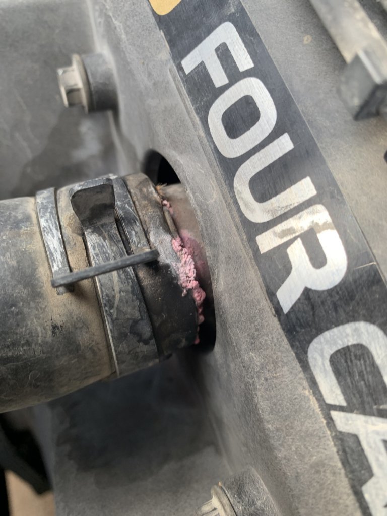

    Well I was wrong and don’t mind being corrected. Here is a picture of my upper rad hose and it does not go through the TB cover. My apologies!
    It’s been awhile since I had this hose off.

    Why all the exclamation points? Its a rubber hose, calm down
    First step is to simply move the clamp to a new position on the hose.
    And/or cut a half inch off the end and push it on farther. The goal is to get the clamp off the thin squished rubber and get it onto a thicker part of the hose.
    And yes check for corrosion crud built up on the aluminum outlet. Scrape it off, brush it off, whatever.
    If it's still leaking then try a new hose and maybe a new clamp

    I was playing around with the engine this weekend and took a second to inspect while that clamp was pulled back. There’s a little metal tab on the top of the engine inlet that inhibits the tube from going on any deeper, but I will be cleaning that pipe with a razor blade as soon as I get a new tube, clamps, and coolant.
