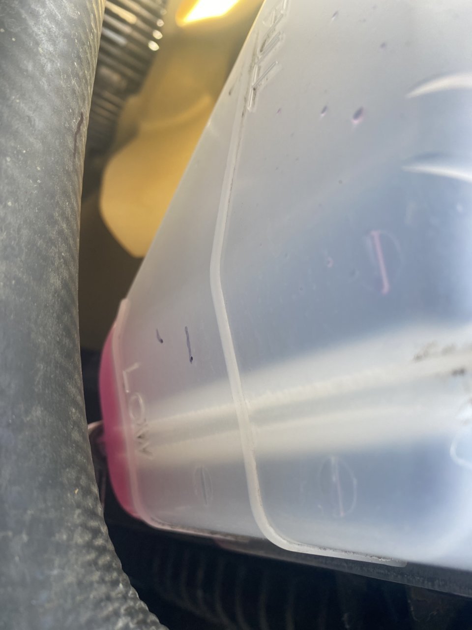

    Hell yeah. Yeah what in the hell there’s no visible leaks anywhere lol and this is where it’s at now

    Is that hot level? Check under / around passengers footwell for any leaking. I guess you’d smell it though. The oil looks normal caramel?
  4. May 31, 2020 at 2:39 PM
    #44
    Rawdoggy
    Rawdoggy [OP] Well-Known Member
    Jan 7, 2020
    #315438
    573
    That is cold level! Haven’t drove it in hours. Oils good. Nothing on pas side

    after looking deeper in the engine, I see some splatter. Unless the resovoir spits up time to time, I’m assuming something is spitting out somewhere. So the level went down to low again, should I try and fill the resi back up? Or just leave it low to take it in that way?

    Where do u see splatter? The vent for the expansion tank is in the front of the tank. (facing the firewall)
  16. May 31, 2020 at 5:17 PM
    #56
    Rawdoggy
    Jan 7, 2020
    #315438
    573
    There was some dried up splatter looking around there, I wiped it clean to see if I could recreate it.. no issue. Never had the truck overheat or anything. Maybe she just likes having that exact amount in the resi. Lol
