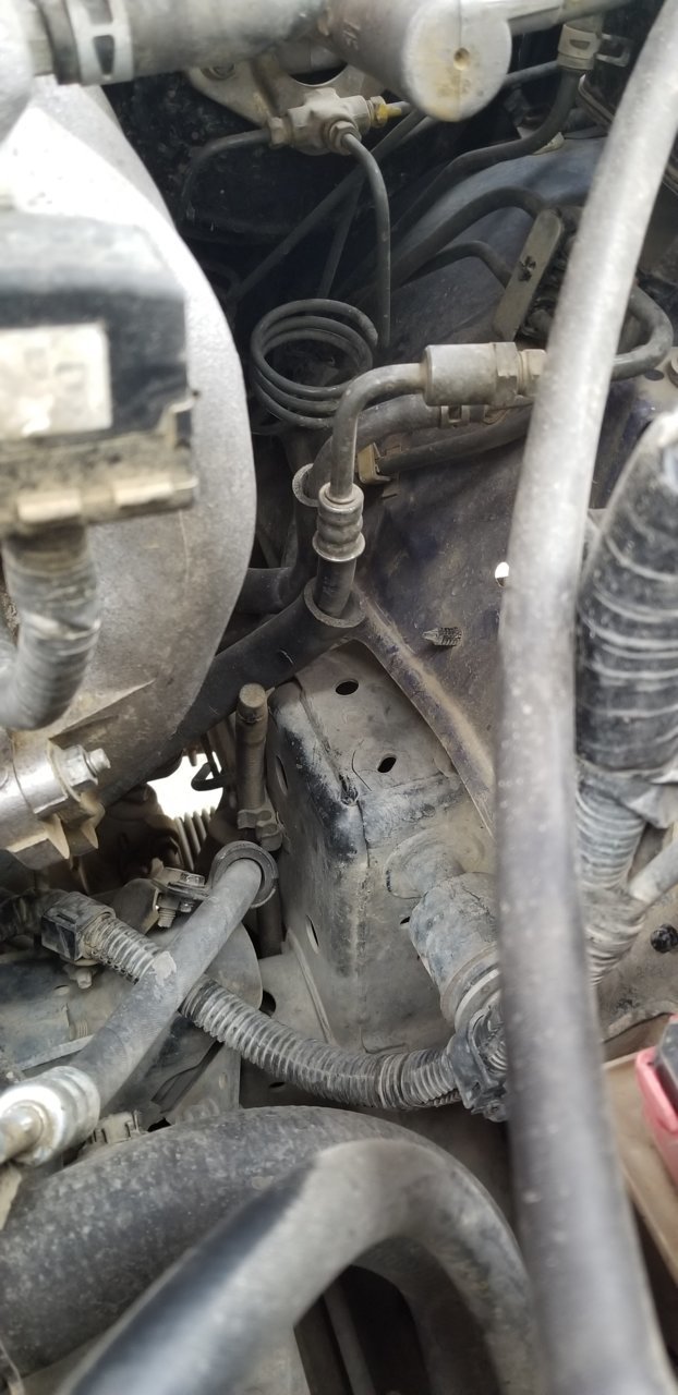

    So I have a 95 tacoma 2.7l 4wd. I just finished rebuilding the engine and finally got it running. When i got back from my initial test drive, I noticed the radiator hoses had both collapsed and the coolant was a little lower.
    The coolant could have just been the system burping (i haven't taken the time yet). But the collapsed hose was concerning. My drive was about 3 miles with 500ft elevation change. My best guess is that it has to do with this hose. I previously posted this picture and someone suggested that maybe it was a coolant hose. I'm pretty sure it is. the little metal cap on the end seems like its some sort of a breather valve or something. They only problem is that I can't find anywhere to plug it in. And as far as I can tell the FSM doesn't have any information on coolant line routing.
    Thanks.

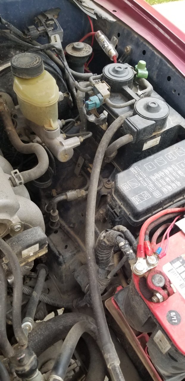

    I have a 2000 2.7L 4wd 3rz-fe tacoma. I do not believe that the line you have pictured is a coolant line.
    Usually, a capped line like that is a breather line for the differentials. You can see the pictures of my engine bay that I have attached and see where my breather line is.
