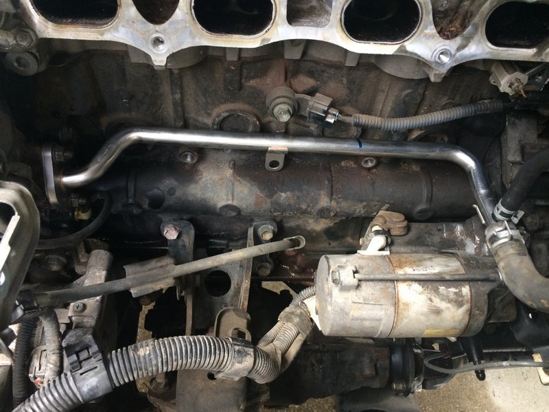

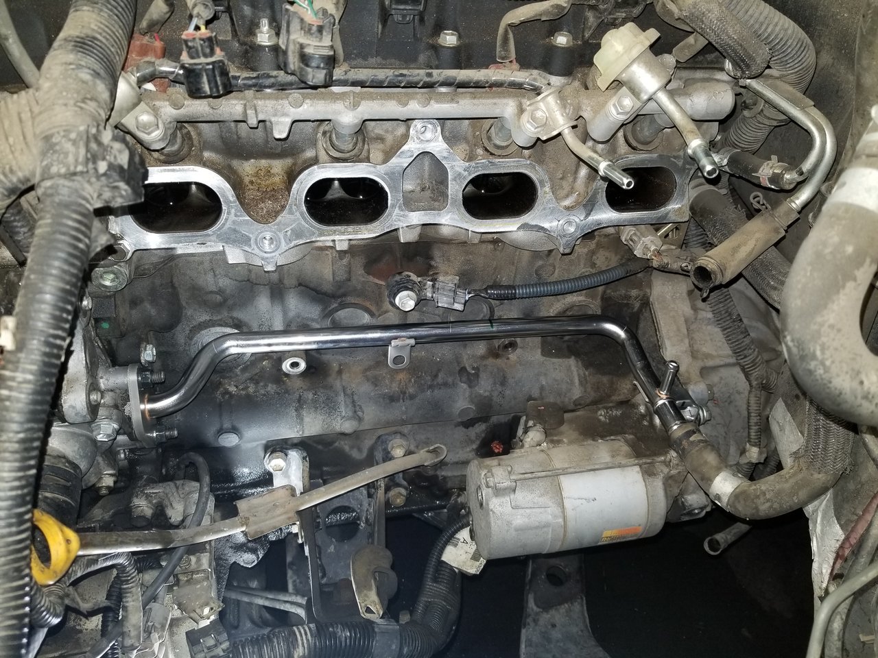

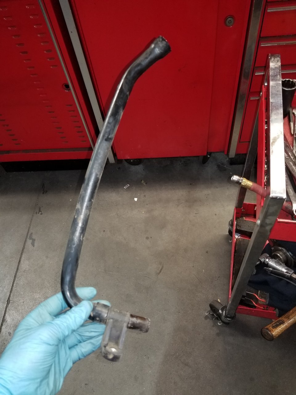

    Or you can check the plastic pipe between your water pump and heater core mine was cracked and I replaced it with a metal pipe from a 2009+ model year 2.7
    $70 at the local Toyota dealership

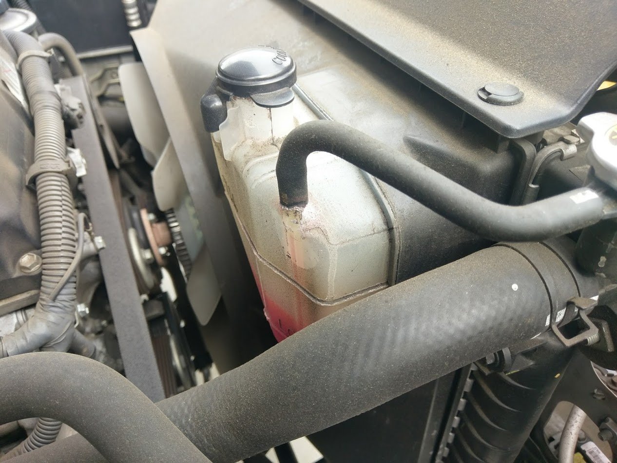

    Can you actually see the leak at the other end if there is one (near driver end) on the water bypass line? So far, saw some pink crusty at the connector of the reservoir tank on top (the hose looks fine outside but I didn't pull it out).

    Can you tell me more about where this pipe is?

    Glad to help. Just make sure you get the metal pipe with the updated gasket.

    idk why the fuck the OEM one would be plastic compound ! i fix mine real quick when i saw that. the new metal pipe should of ben a recall.

    it took about 3hours and thats with a lift

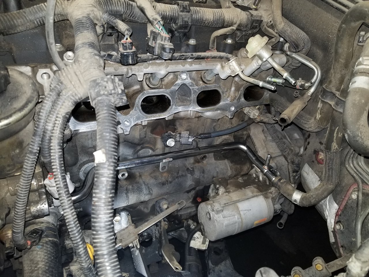

    need to remove the - clampon the battery then take out the throttle body and intake manifold off (going to need to move some wires) the 3 hoses by the firewall the one small one is a big bitch to take out and put back in, i also take out the tranny dip stick plus remove the starter and you should be good (you going to need 2 things of coolant to fill the truck) it took me about 3 hours to do and that with a lift
