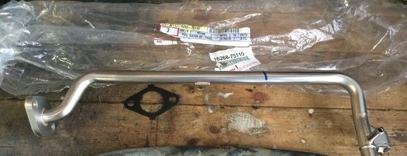

    What you see in your video is probably oil. It isn't coolant, it would be pink.
    Look by the oil dipstick here:
    That is the coolant bypass pipe leaking. Known issue is a plastic pipe. The replacement is a metal pipe.
    https://www.tacomaworld.com/threads/leaky-gasket-on-coolant-bypass-housing.417873/

    Probably just seeping oil leak at the valve cover gasket. Its an 2005 and the gasket is old and dry.
    Clean it real good with some degreaser and keep an eye on it and you will be able to see where it starts leaking.
    As for the coolant "leak" it will show as a dry pink crust. Keep topping it off and it may stop when all the air is out of the system.

    You might also check the other end of the bypass pipe at the firewall. The large end hooks to a heater hose, but there is a smaller nipple that points upward and has a small hose attached that runs to the throttle body if I remember correctly. That nipple has a tendency to crack and break off. check this area for leaks, but be careful not to move the hoses much unless you are ready to change the crossover pipe.
