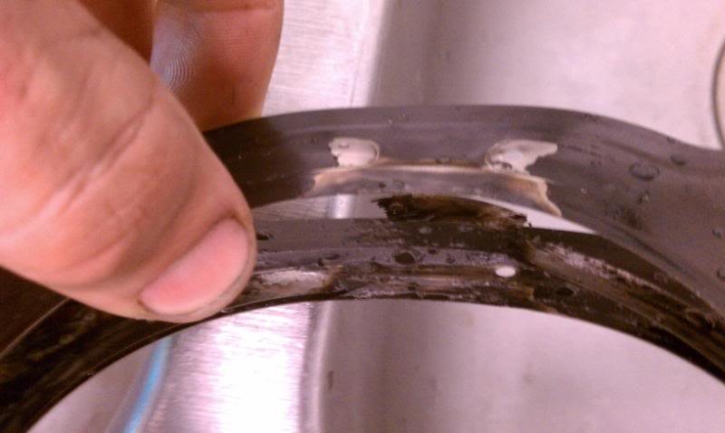

    Lots of miles with boost, on a motor designed to be N/A is the cause. Not a filter or pulley. The factory head gasket is weak by design. The added stresses of boost, just mean it will fail sooner.

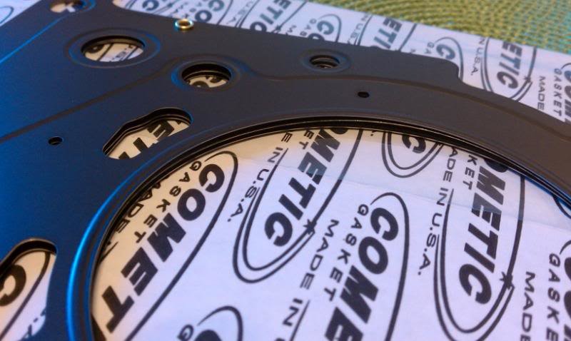

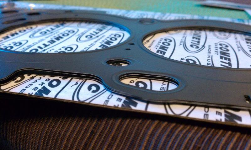

    Here is the Cometic MLS head gasket:
    Here is a blown OEM. Notice the difference in the thickness of the middle layer:

    Can I assume they make these gaskets for our motor? Where can we find them?

    Yes you can. See the writting on the cardboard?
    www.Cometic.com.
    Just search for the 4.0 V6 headgaskets. You need one for each side. Obvious, but necessary to mention.
