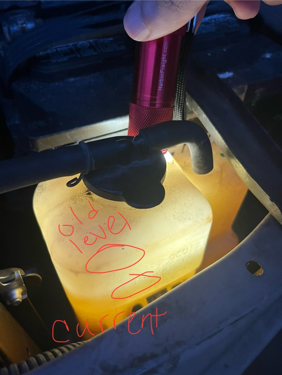

    so i just ran the truck up to operating temp with the cap off. scangauge said temp was 184 and i let it idle at that temp for about 7 mins. i put the cap back on and let it cool. it appears the reservoir level is a little lower... im hoping the original cold system gush was because it was overfilled? any experts on the matter? thanks! will edit to include photos.
    in the photo you should be able to see the old reservoir line and the new level its currently at after cooling. (its only been 20 mins cooling)

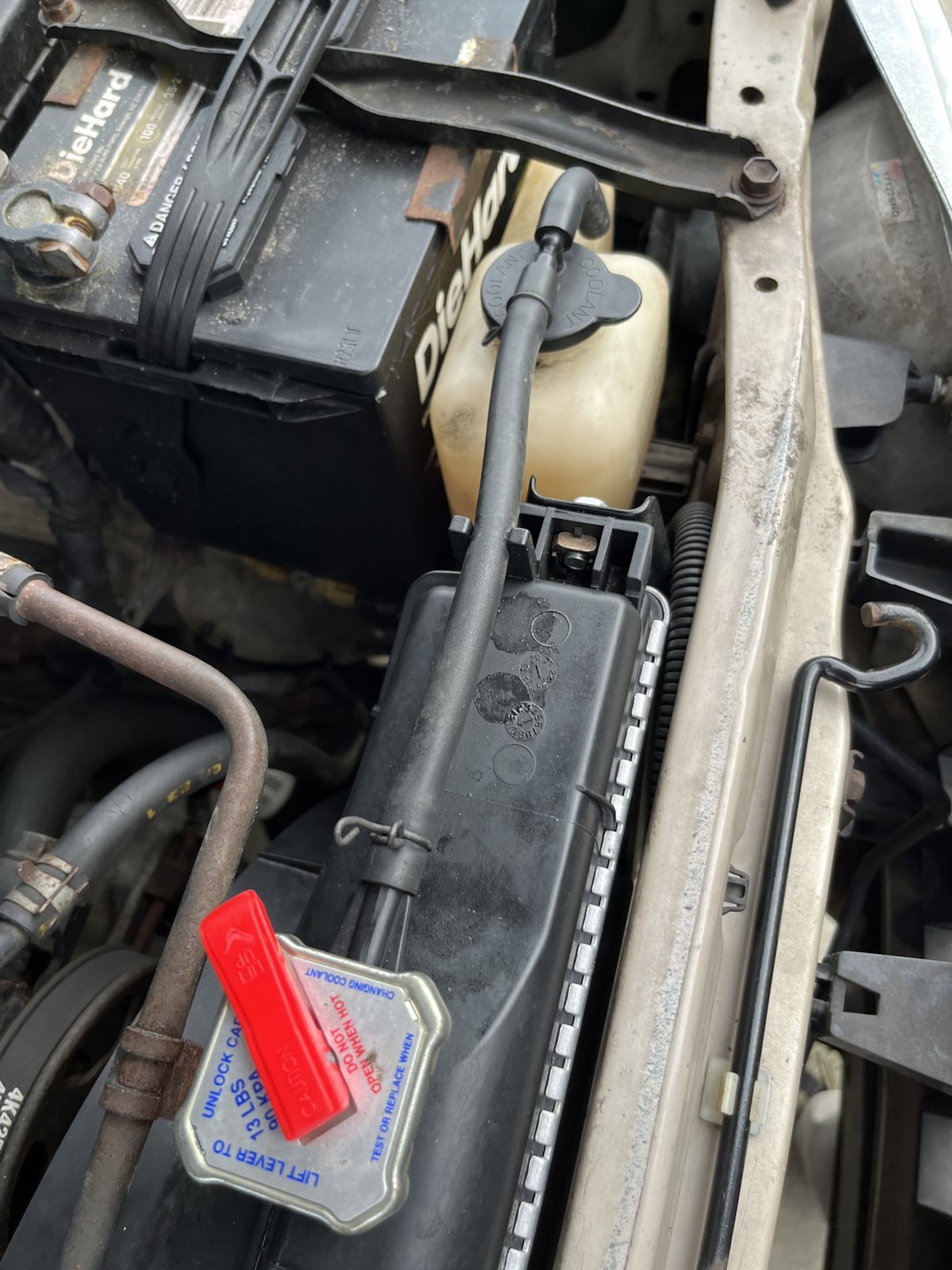

    Haha uh oh. They installed some aftermarket cap that has a red pressure release handle before it can be spun off. Should I go get me a genuine Toyota or nicer one?? I’ll try and attach a pic

    this is my thought as well. open cap, see that it is full. level off reservoir to correct level at the temp you happen to be at and watch it?
    I would change that cap, even if only so the TW crowd won't lynch my ass verbally when they see it :D

    Yeah, I have owned a lot of Toyotas that had picky cooling systems (many 1st Gen MR2s) and a factory cap was always the way. Whenever I see an aftermarket radiator cap on *any* make of car it's the first thing I would replace if it has cooling issues. The Toyota cap is perfect for stock engines. Toyotas are reliable only as long as all the parts are Toyota in most cases.

    Get rid of that radiator cap, it's likely keeping the overflow system from working properly. Those things are not designed for modern vehicles
    Just the fact that they chose to install a pre-historic cap like that makes me wonder about the skill and experience of the shop..

    just called the local toyota dealer and they have a cap in stock 33 plus tax.. going now. will report back in a few days or next week.

    For real :frusty: I guess they don't call it the stealership for nothing! I opened the system once since the new cap. System was stone cold. No positive pressure like before. Still gonna take it in to have the heater core diagnosed and see what else they find on the first week of New year.
