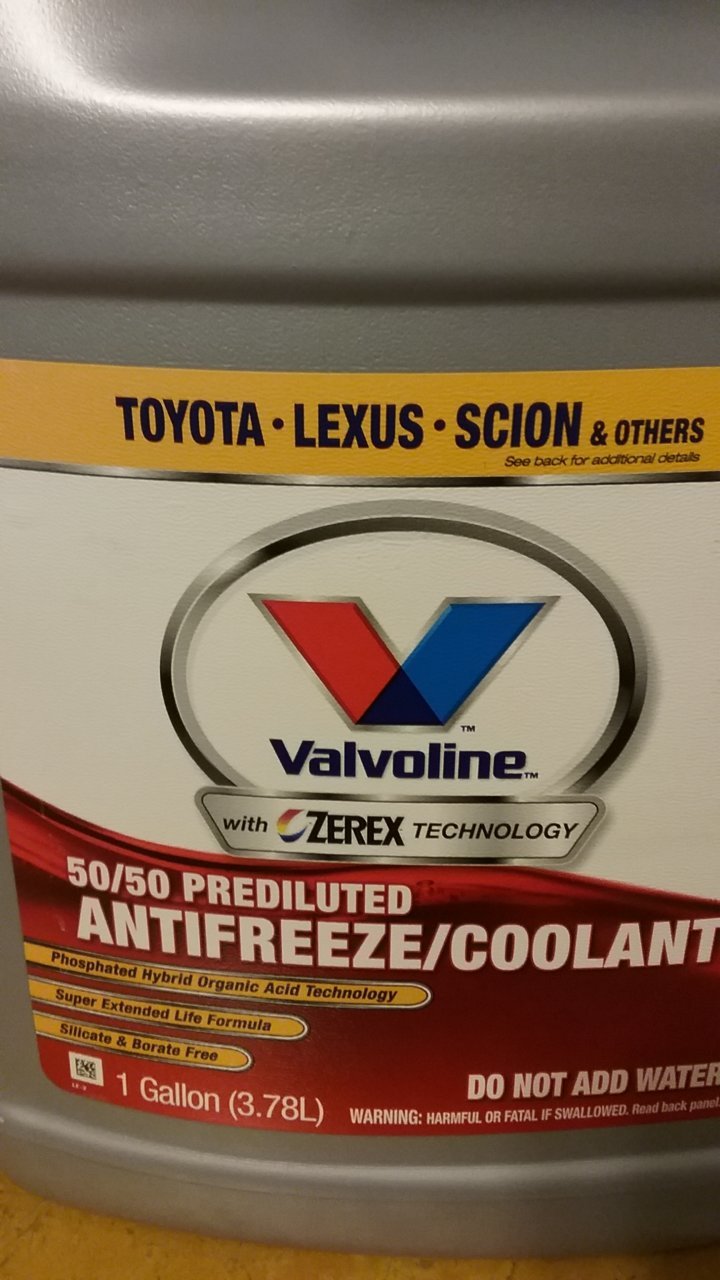

    Valoline Zerex pink premix. Nearly identical to SLLC. Available at Wal-Mart. $13 a gallon
    Silicate free P-HOAT formula

    Mixing different coolant chemistries will not work out well.

    Toyota specs a silicate free P-HOAT formula. Stick with that and you're good. Ultimately the color is not important. The Zerex is available in pink for Toyota and blue for Honda. Having the color match is really for aesthetics. You don't get any weird color mixing. But that doesn't hurt anything if it does.
    I really like the stuff. Been using it for years in all manner of Toyotas in my own and extended family's vehicles.
    So easy to use. No mixing to worry about. 100% compatible with SLLC. It's available on the shelf at Wal-Mart and half the cost of SLLC.
    There are no cons :notsure:
