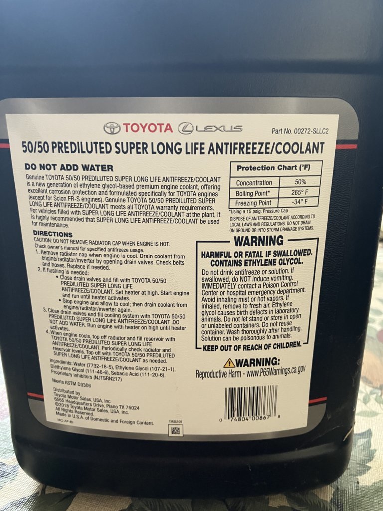

    I'm under the impression that super long life premix is good to -35, which might just be cutting a little too close for comfort for me. Do you have anything that proves -50? Currently i have the pink premix in.

    It’s -34. Just looked at a jug I have setting here.
    And I tested mine after just doing a drain and fill. NOT a full flush. So I had a mix of 130k miles and 13 year old coolant mixed in. I got about -20/-25ish when I tested it afterward. Using one of those shitty floaty ball tester. (How ever good they are :notsure:)

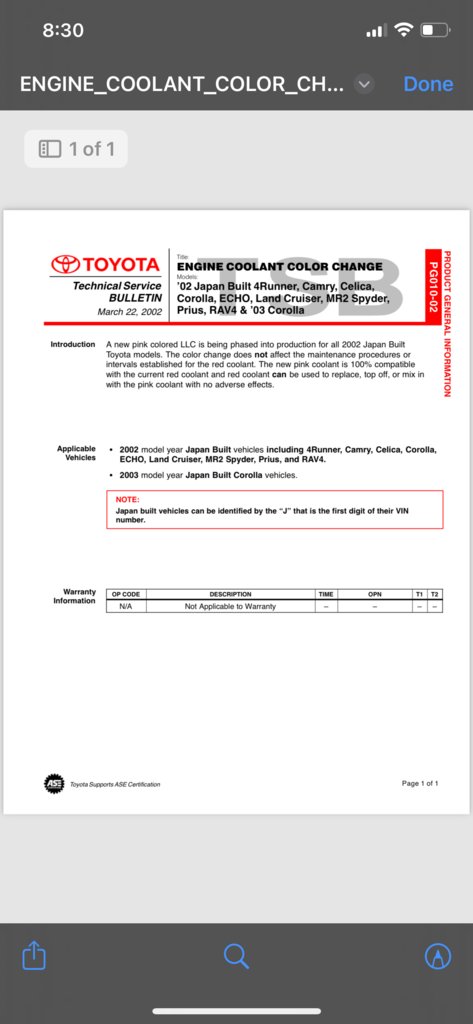

    Is there any reason to avoid just draining ~2qts of pink and replacing with 2qts of red, to make it 4qt water 6qt coolant at 60/40 since total is 10qts. Or is it necessary to flush pink. They seem to both be glycol based and made for aluminum, just with different service life, but I do maintenance more frequent than manufacturer recommends anyways .

    Maybe is rated for -35 but whenever I test it, I usually see -50 on all my tools.

    Here is a TSB I found, seems like I should be fine to mix, I’m not going to be in Alaska for very long and this pink coolant I have in currently is only 4-5 months old, so i really don’t want to flush out yet.
