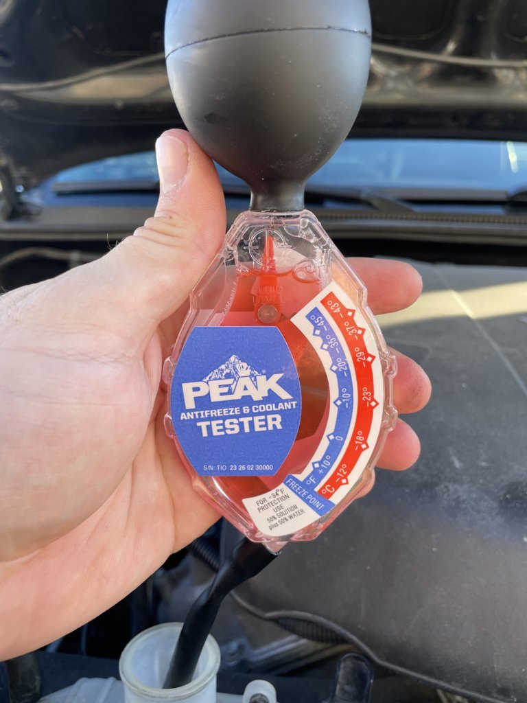

    Just went and bought a cheap tester, because I was interested to see. It seems as tho the pink coolant is good to roughly -50. No clue to accuracy of these tests, but it is most certainly maxed out.

    You can "calibrate" those cheap testers with a 50/50 mix. Put 2 ounces of coolant and 2 ounces of water in a disposable cup. Or whatever. Just make it half and half. Mix it up. Test. You should get ~-35F. My ancient Prestone tester was off, so I marked the gauge with a sharpie. If you want 60/40, whatever your goal, then do that and mark accordingly.

    Yes, i was just curious to what a tester actually said, @Bishop84 had said earlier that premix was good to -50 via testers, which that seems to back up, but you are saying that the testers are not calibrated equally and some will show higher numbers even though 50/50 is rated for -34?
    Either way i am going to be changing the concentration to 65/35 to make sure i have no issues with the cold during the stay. Id prefer to just drain 2.5 qts of pink and add 2.5 qts of red to achieve that without having to flush the whole system as the coolant in it is only a few months old, but answers around doing that seem to be mixed.

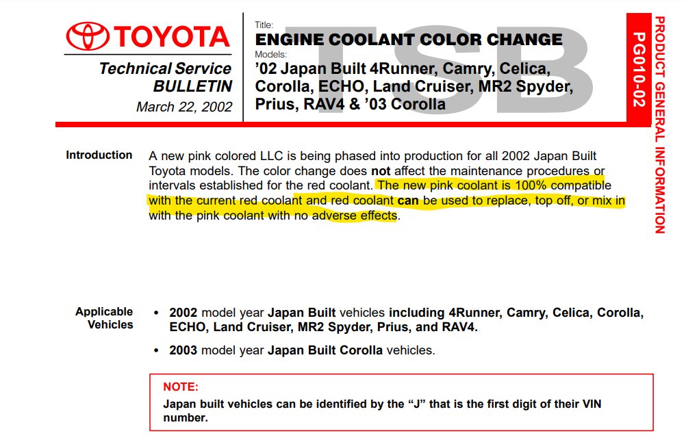

    The topic of coolant compatibility keeps coming up, and there is a LOT of misinformation about it.
    Here are FACTS about the coolants used by Toyota:
    Up to 2005: Toyota Long Life Antifreeze Coolant p/n 00272-1LLAC(-01) in RED sold as concentrate** for 2 years -or- 30,000 miles (whichever first) and must be mixed with distilled water
    2005 on: Toyota Super Long Life Coolant p/n 00272-SLLC2 in PINK sold as pre-mixed 50/50 for 5 years -or- 150,000 miles (whichever first)
    Toyota issued a TSB on the color change from red to pink coolant in 2002;
    Moxman6[OP] likes this.
