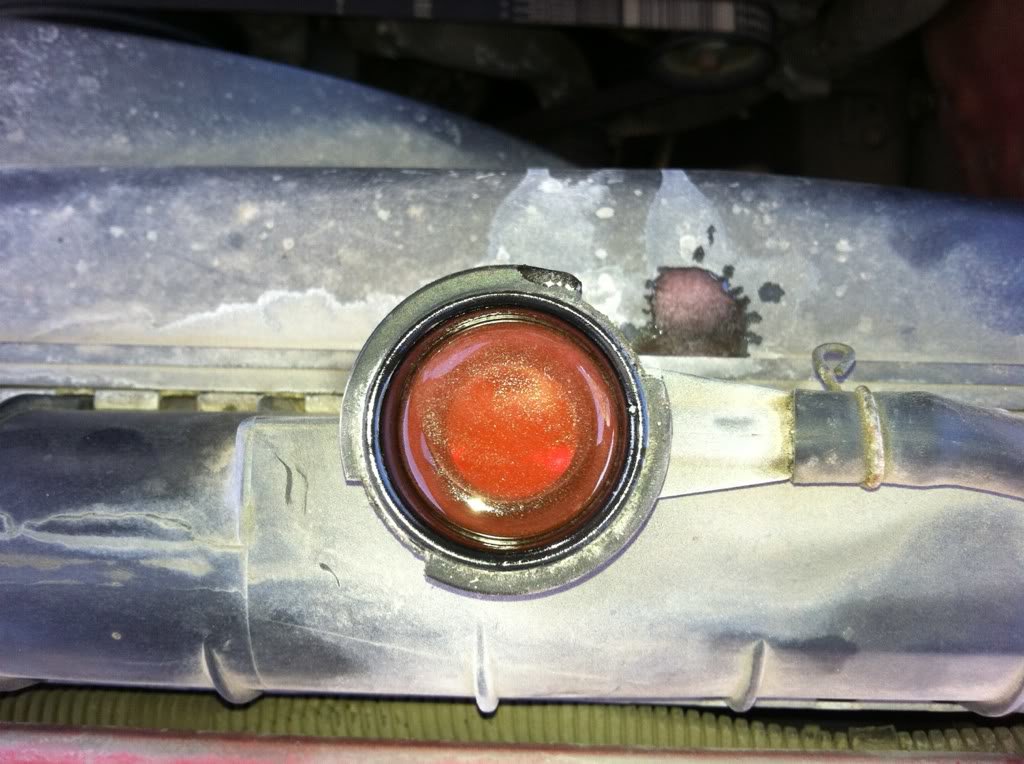

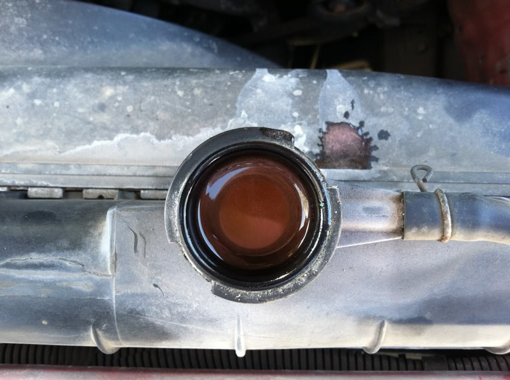

    My truck currently has 160k miles on it and I am thinking if I need to change my coolant or not. I don't know if it got done when Toyota did the timing belt at 148k miles when the previous owner had it. Here is a pic of the coolant, what do you guys think?

    Do you know if thay did the water pump at the same time? If thay did not. Thay may have not drained your coolent. From the pics, It looks like it needs to be changed. Toyota will tell you to change it when it gets that rusty color. I would change it. Check your hoses also. If your hoses need to be changed, I would change your T-State also. Just my $0.02 :D

    Ya the water pump and timing belt were both done at 148k.

    Maybe it's my monitor that needs adjustment, but that DOESN"t look green to me.. but, St. Patricks day is over, maybe I need to adjust my monitor again.

    Flush your coolant system!

    Toyota coolant isn't green, it's red

    unless green coolant was put in it...the color is normal besides the sediment and other floaters you see in it.
    If the water pump wasn't done...do it. If it was, just drain and flush your system and refill.

    x2 flush the system, block and all and refill with toyota long life antifreeze. That should do the trick.

    When I had my '99 PreRunner, green coolant was used. "Newer" Toyotas used either the pink or red coolant.

    My 99 taco came with red. Red is better
