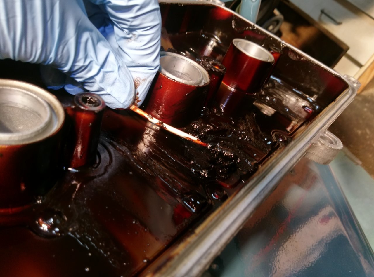

    When you pull the heads, have a machine shop do a valve job, DO NOT MILL THE SURFACE OF THE HEADS your timing will never be correct again. Buy the whole rebuild gasket kit, replace all the gaskets. Replace Cam chain tensioners and timing chain guides, make sure you remove the upper oil pan and clean it out!!!! clean the inside of timing cover, valve covers, follow service guide to the letter on amount of FIPG to use on every seal.
    Last suggestion... Pull the motor to do the work.

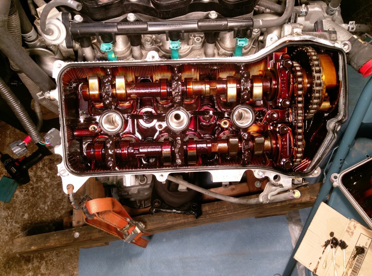

    Problem with buying a new engine is you need to know it's history. If I were you, and have done this many times, before you buy an engine, pull the valve covers, that will tell you alot about how well it was maintained. Also drain the oil, look for metal. If you can, buy an engine from someone you know.
    Prime example, I was going to buy this 1GR-FE with only 60k miles, pulled valve covers... it wasn't taken care of... I passed...

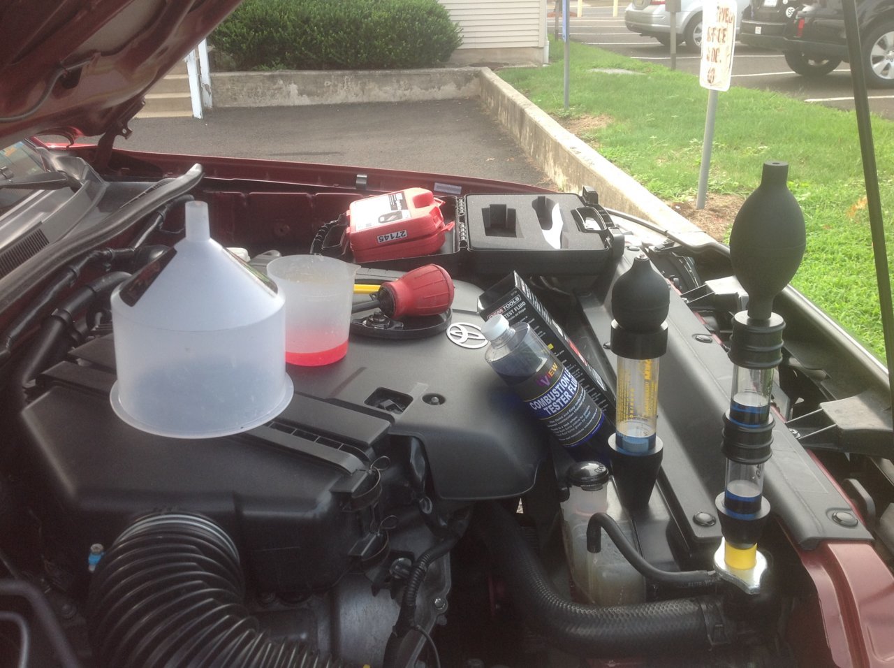

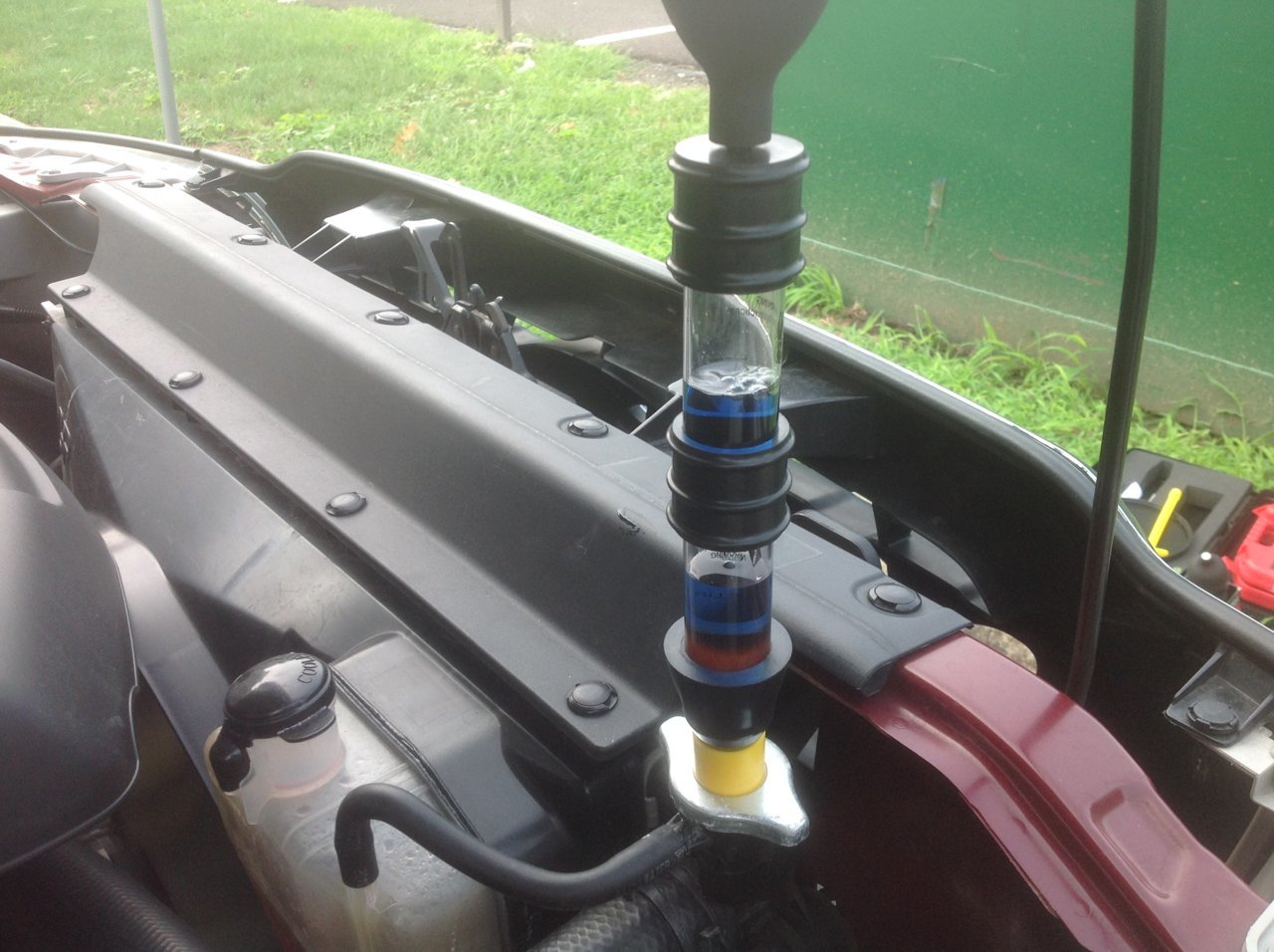

    Regarding chemical block testers, I rented the single and borrowed a twin chamber tester and both did not show yellow color change. Apparently the blue chemical properties expire. The instructions on the twin unit said to test the blue agent against CO2 exhaled into your hand.
    You can see the bubbles in the upper twin unit as the coolant is rising into the bottom section. In addition to removing coolant from the top radiator I got extra space to expand buy using the The no spill funnel adaptor

    The funnel is a no mess way to check for bubbles

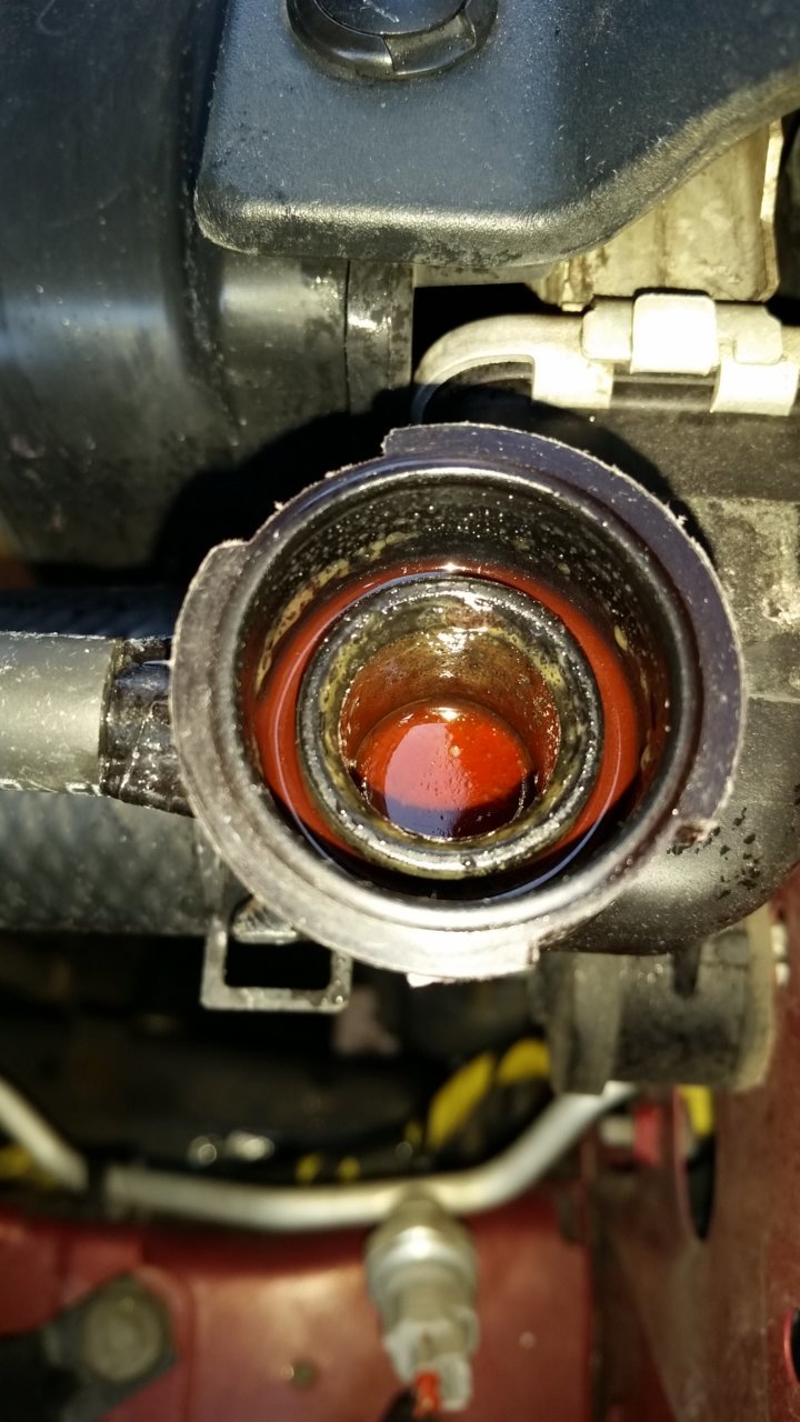

    that overflow is dirty, is it on the out side or inside?

    Its oil residue in the coolant. I'm certain on a headgasket very soon. Results back from last week's oil sample and no evidence of a head gasket leaking into the crankcase. No appreciable loss of of oil or coolant either. It was gurgling in cooler weather but since it's been hot I've not heard that.

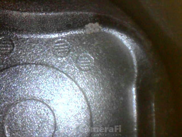

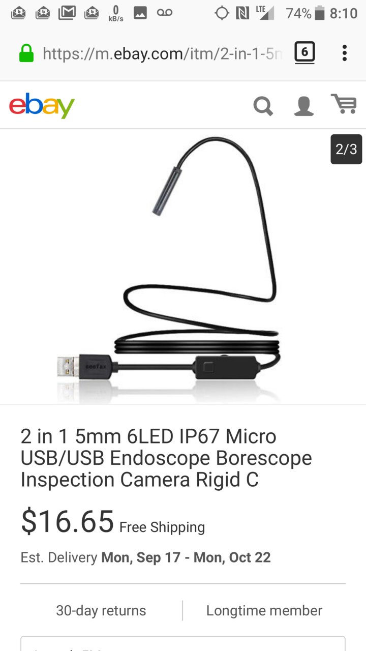

    Hmm, have to think on this one, I'd buy something like this, and scope the cylinders (I have 3 of them, I buy old HTC M7 phones of eBay for like $30 and use as monitors, so if you drop it, no worries, but you can use any old phone) Screenshot_20180828-201027.jpg you hook the USB endoscope to a phone or laptop and you can scope the cylinders through the spark plug hole. You can record the video and/or take snap shots. You can use for a million other things to. It's less than $20.

    Thanks. I'll give that a try

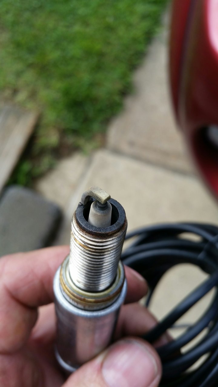

    When I saw the oily residue a couple weeks ago I confirmed a slight coolant loss. The tail pipe looks super clean but no visible vapor. Changed the oil and sent to Blackstone Lab.
    Topped the oil level next day and will check it Saturday.
    Thanks for the suggestion. You have a more detailed procedure? Speed, time, miles, Etc. Do I send you the vapor sample?
    Will pull the plugs this weekend and check the cylinders with the borescope as per

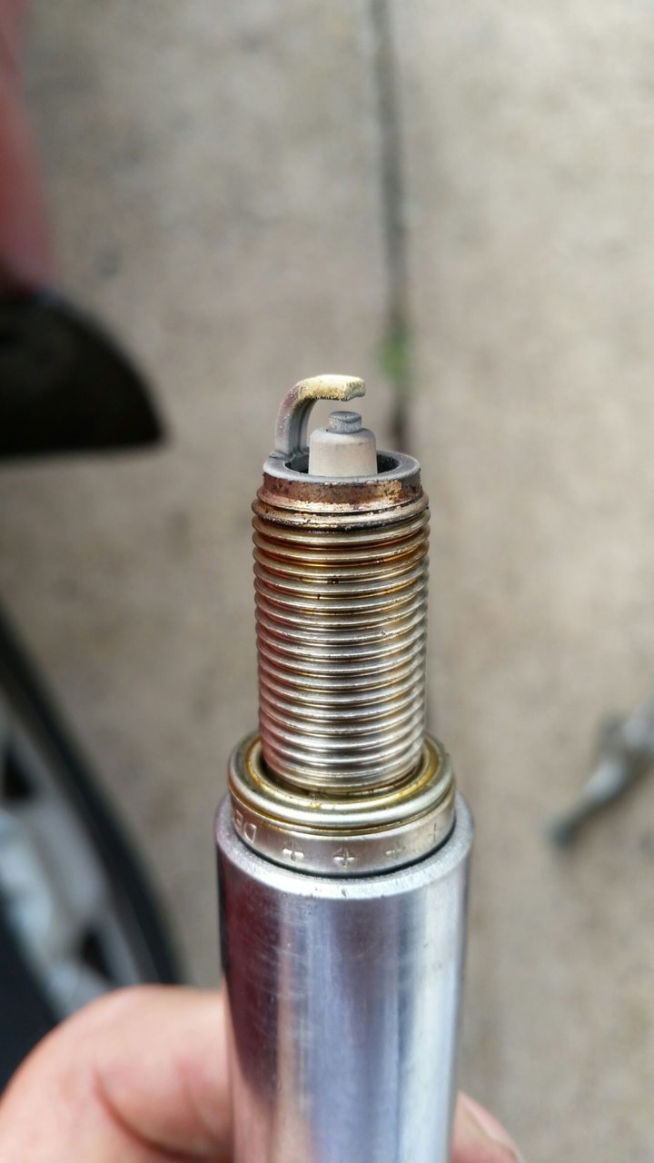

    Got this far today with the borscope camera checking both rear cylinders.
