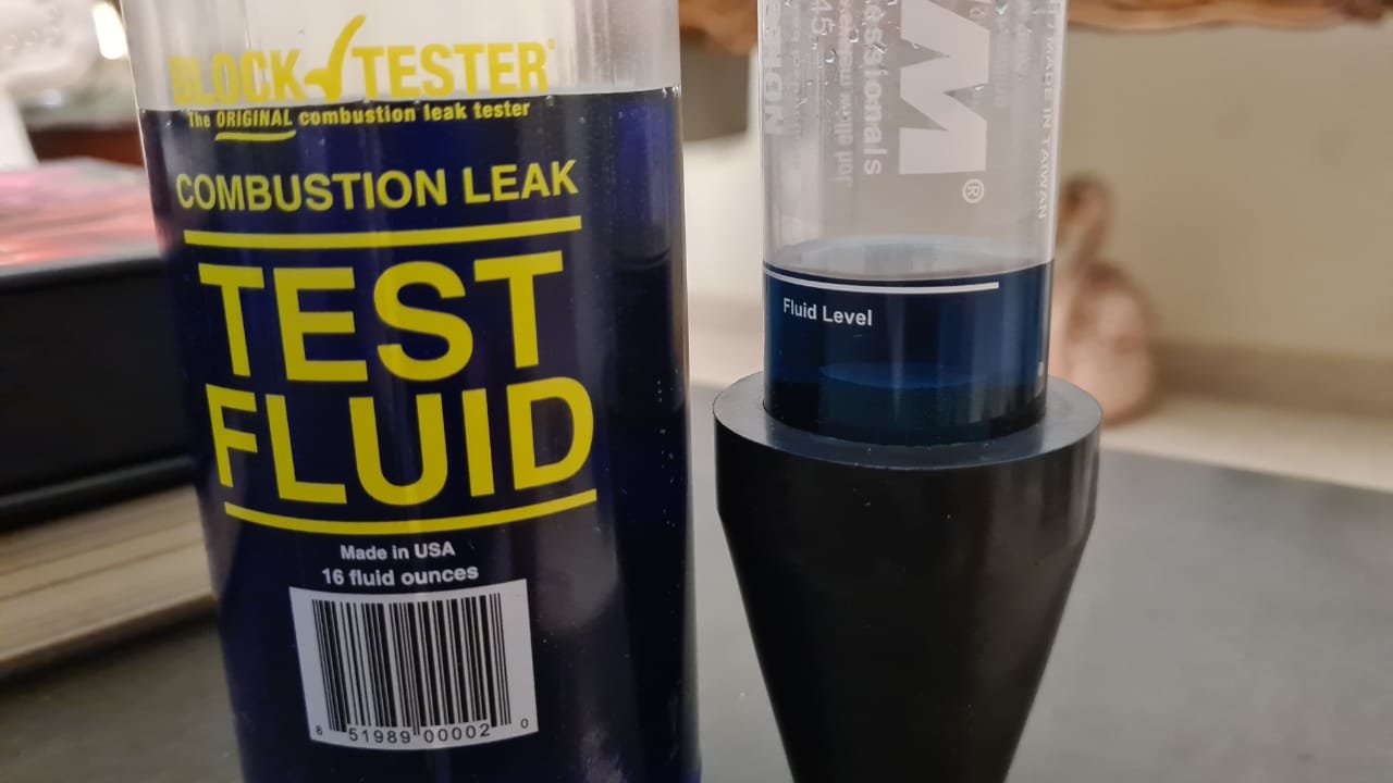

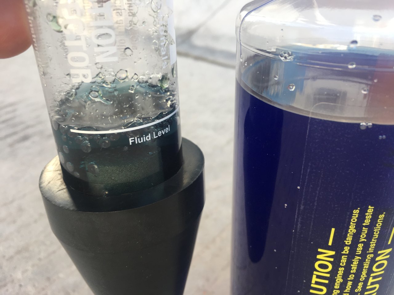

    Hi guys. Soooo this all took a lot longer than I had anticipated. Have barely used the truck, except in order to run the chemical block test, twice. And I can't even get a definite answer there.
    First time I only drove it around the block a few of times until the temperature gauge showed a normal operating temperature. Then I used the probe directly on the radiator (as the videos suggested) and this was the result:
    It looks like there was SOME reaction, but definitely not the yellow I was waiting for.
    Next time I drove it for like an hour around town until I saw the first bubbles in the overflow tank. Parked it, and did the test again, but this time on the overflow tank. The result looked like this:
    Nobody down here has even heard of this test and all I could find was the actual tester made by OEM, while the fluid is from Block Tester. Anybody knows if that is an issue? The tester sealed well, and I went way past the 2 minutes prescribed in order to get ANY results. As Blue + Yellow = Green I am assuming that there is a combustion leak - just very small.
    Any last ideas? I can't find a decent engine here neither, so I'll baby it home (700 miles) and have a friend bring down all the replacement parts for the engine and try this myself. Always wanted to open up an engine - I won't be getting a better opportunity than this I suppose.
    Thanks for all the help and sorry for the delay.
    Julian
