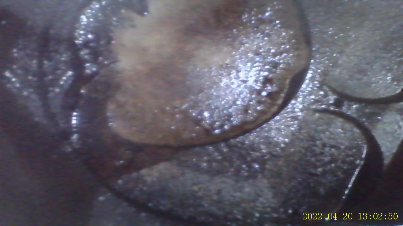

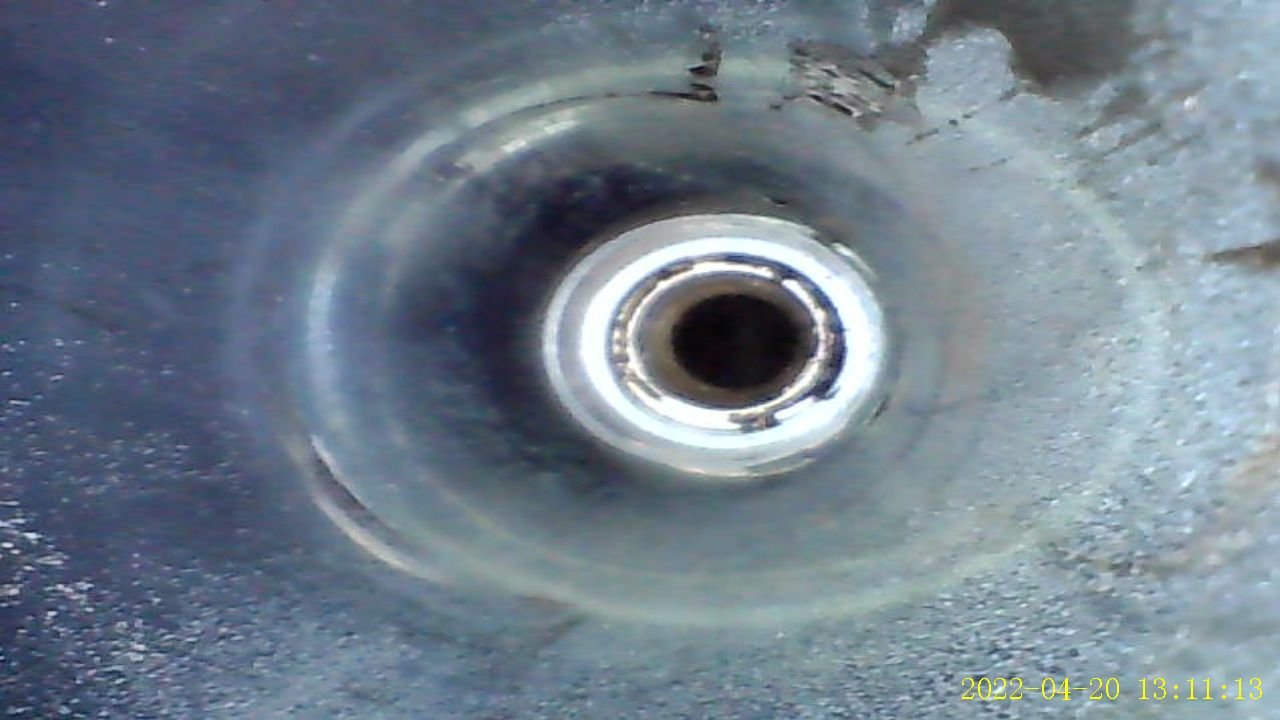

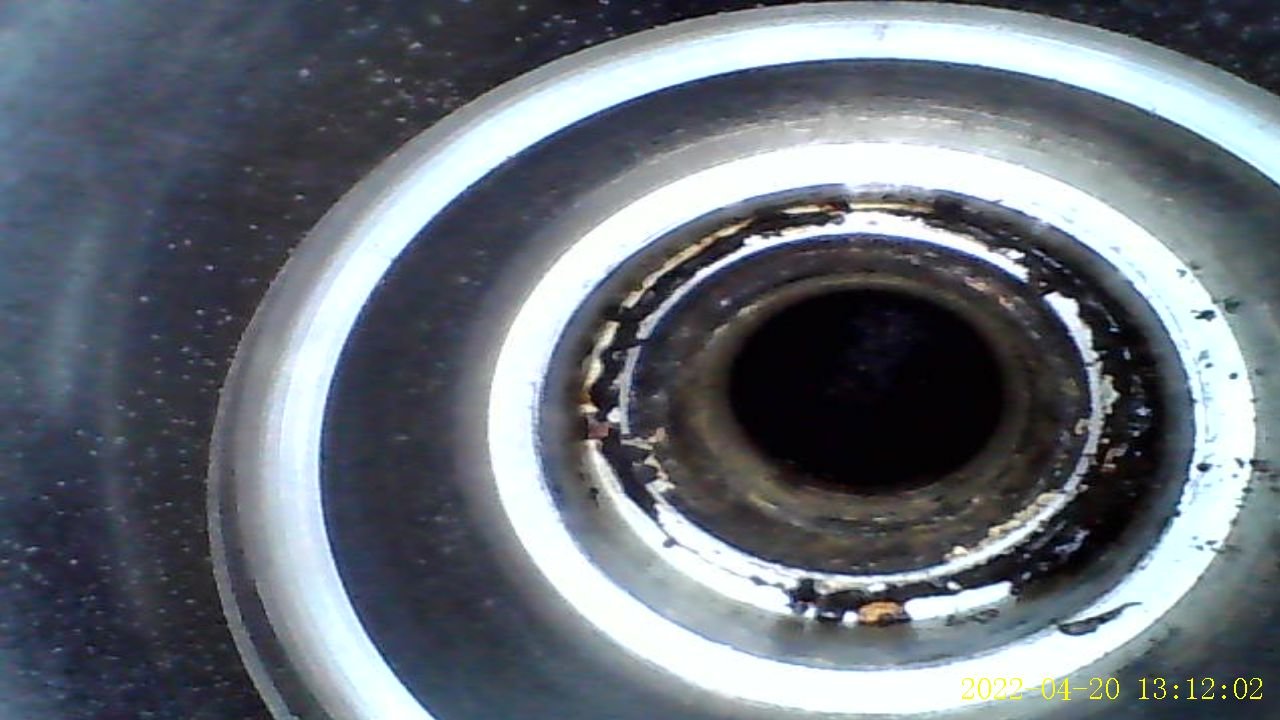

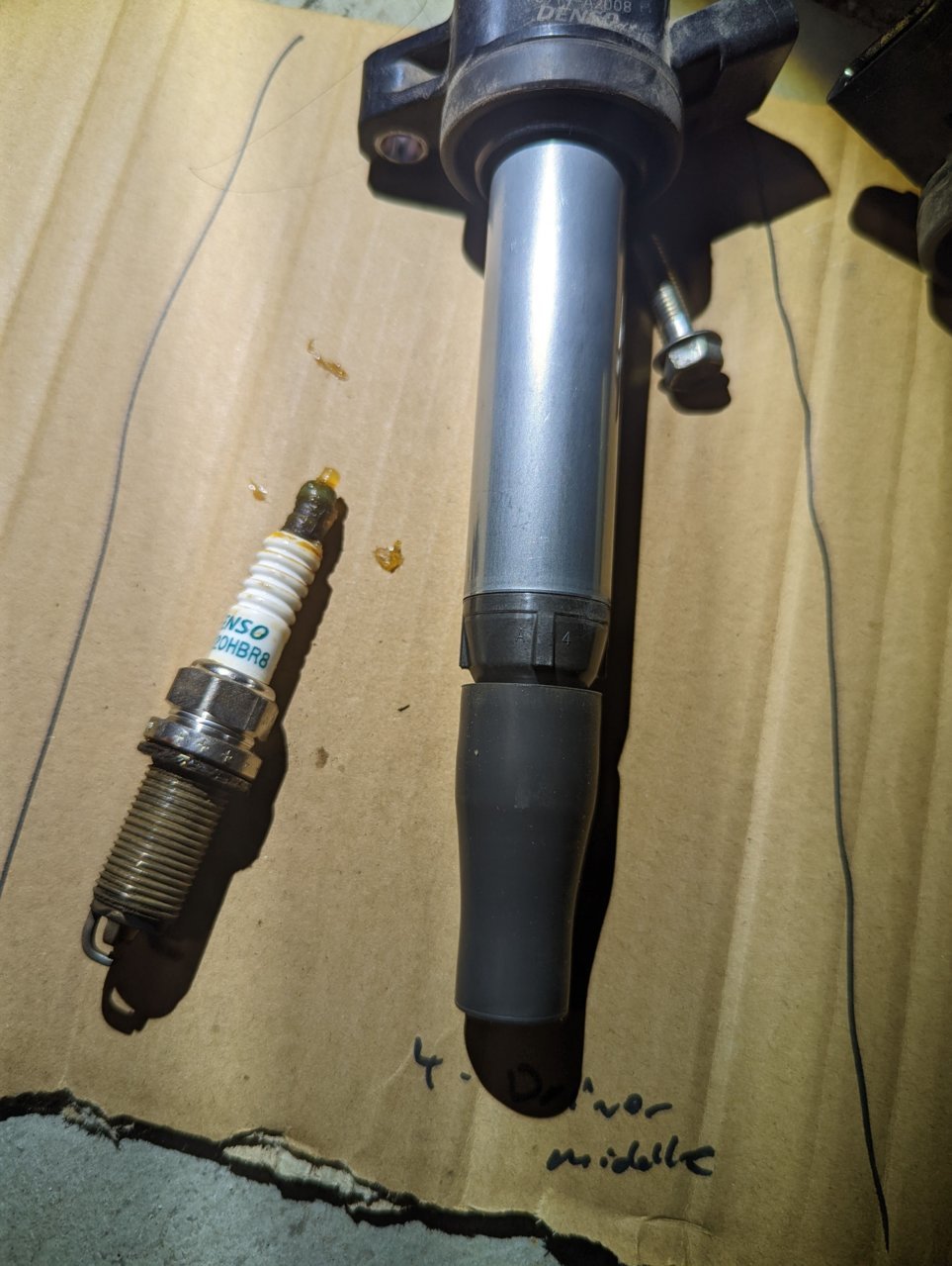

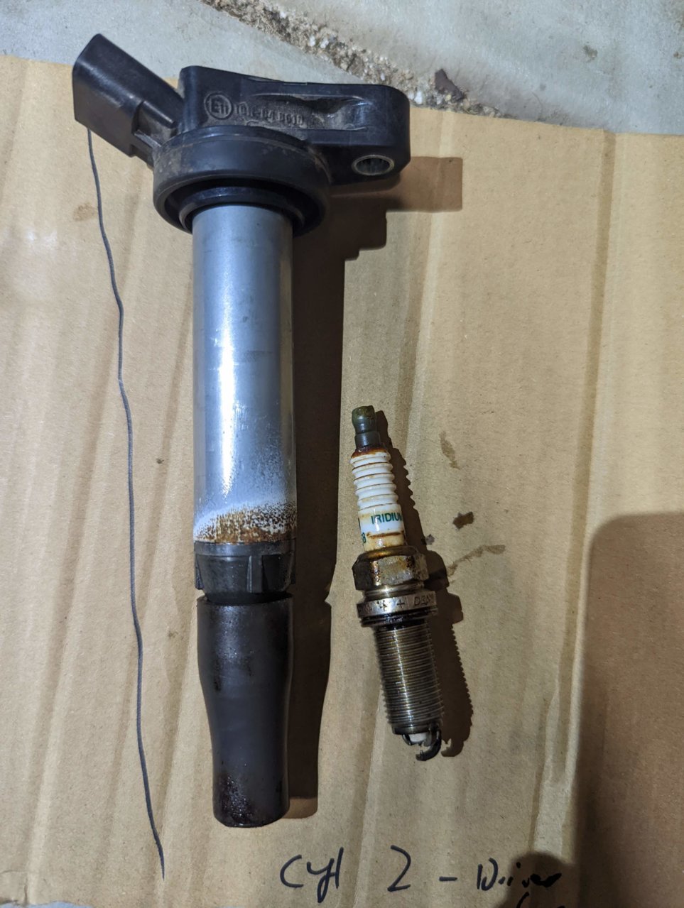

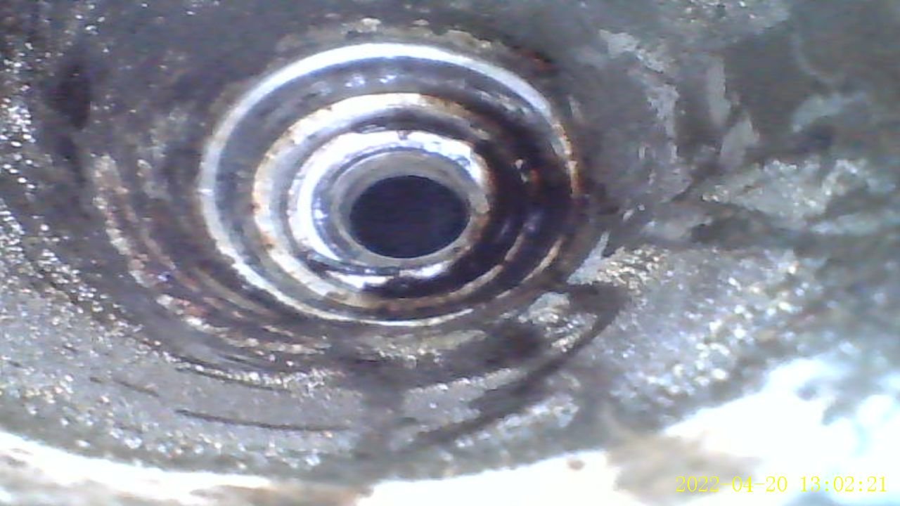

    Well. I pulled cylinder 2 and 4's plugs. blown head gasket. oil on the plug and ignition boot.
    cylinder 2. driver front plug and boot.::
    cylinder 2 scope view:
    cylinder 4 plug and boot::
    cylidner 4 scope view:
    Looks like i'm goign to need to repair this engine!

    Hard to tell from the pics if stuff has been 'steam cleaned' enough to indicate a HG. Ill let other guys with more experience chime in.
    Also the oily residue on the top side of the #2 plug and coil boot could just be a tiny amount of residue accumulated over time due to that plug not being quite tight enough. There have been other threads on here showing that

    hard to see int he pictures, but the plug on the ignition side definitely has oil on it.

    the white porcelain tells the whole story. it should have a darker tint to it..
    *unless the plugs were recently replaced? How many miles on the plugs?

    I've seen oil on the boot from the spark plugs being a little loose. Saw pictures of that in a couple spark plug replacement threads but that #2 cylinder looks really wet for sure. Should be coolant not oil. Guess it really doesn't matter at this point. If you put a coolant system pressure tester on the radiator and pulled out the suspect plugs you would eventually see coolant building up in the combustion chamber(s) pretty fast.

    You definitely have a spark plug tube seal leaking on your valve cover. That is the source of the oil on the boot and plug. I don't see anything that indicates a bad head gasket. You would need to do a compression test and leakdown to see if any compression is bleeding into the coolant system. Inversely, keep the plugs out and pressurize the coolant system to see if any coolant bleeds into the cylinder.

    I think the extreme wetness on that piston head indicates something gave way and that "steam cleaned" porcelain electrode base so to 100% verify quickest way in the given state of disassembly the motor is in now is to just use a coolant pressure tester.
