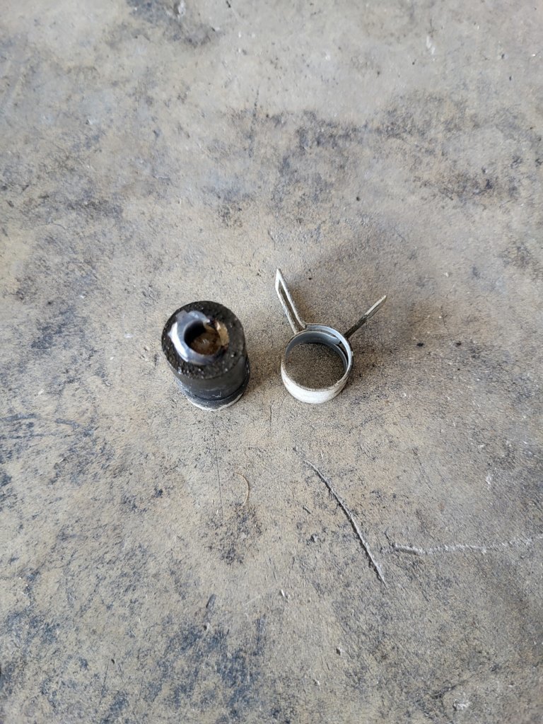

    Managed to snap mine off when trying to drain the overflow reservoir. I'm planning to just JB weld it closed for now. Any other options?

    What did you do? This just happened to me today…

    I’d remove the shroud, cut off what’s left of the plastic nipple, drill it out, and JB Weld a brass barb fitting in place. It’ll work just fine.
