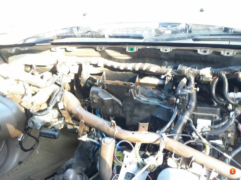

    You did the easy stuff, but unfortunately, if your windows are fogging, you have to replace that heater core. Ugh!

    Would it be under the dash?

    You can get a general idea of where the heater core is by locating the hard pipes at the firewall. Your heater core is on the other side.

    Its done no more leak and foggy windows

    Good to hear. Typically the only thing that can cause fogging of the inside of the windows (and that sweet smell of coolant that often accompanies it) is the heater core. They're just not so easy to see leaking because the coolant either soaks into the carpet or drips out the AC condensate drain. Glad to hear you fixed it though. How long did it take you to swap out the heater core?

    It was PITA! Took about 8hrs.
