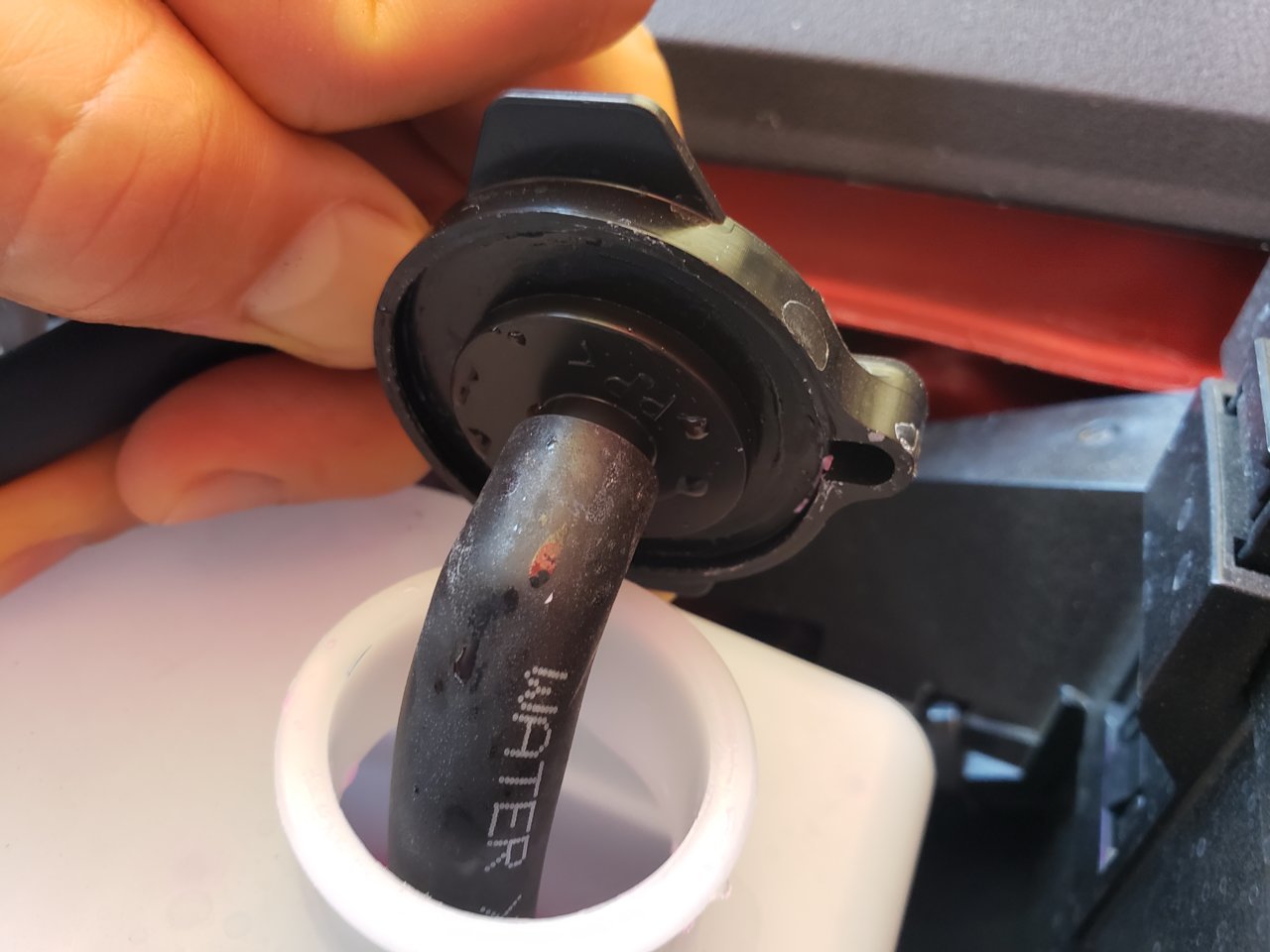

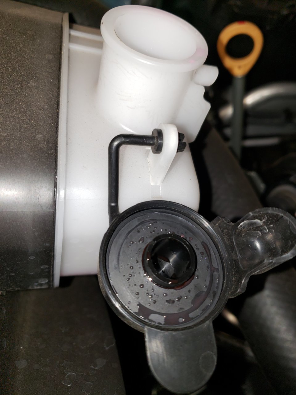

    The lid for the overflow tank has a vent, and sure enough there is a small amount of residue there from coolant sloshing around. Both pictures show the vent on the right sides.
    Coolant recovery tank lid from wife's 2019 Camry:
    Coolant recovery tank lid from 2019 Tacoma:20190727_093814.jpg

    Scheduled an appointment just in case. Also getting its first service. I’ll keep you guys updated.

    So they said there are no leaks and it is normal. He said because of the overflow recovery tank like @MtnFisher stated.

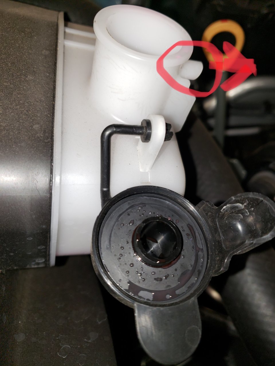

    Someone said overflow tank was sealed.. just checked today and it is not sealed..
    @MtnFisher shows on his pic:
    So I guess it would be normal to smell some when engine is hot...

    Pic please.. I strongly believe it is not sealed.
    Had 4cyl 3gen and now 3.5 and both are vented.

    The overflow bottle is vented. The system is sealed. with a cap that allows coolant to be drawn into the Rad from the Rez, as the coolant cools off after shutdown. The same cap will allow coolant out of the rad, as it expands . But it is a sealed system.
    The cap allows psi to build, which raises the boiling point too .

    Got it!
