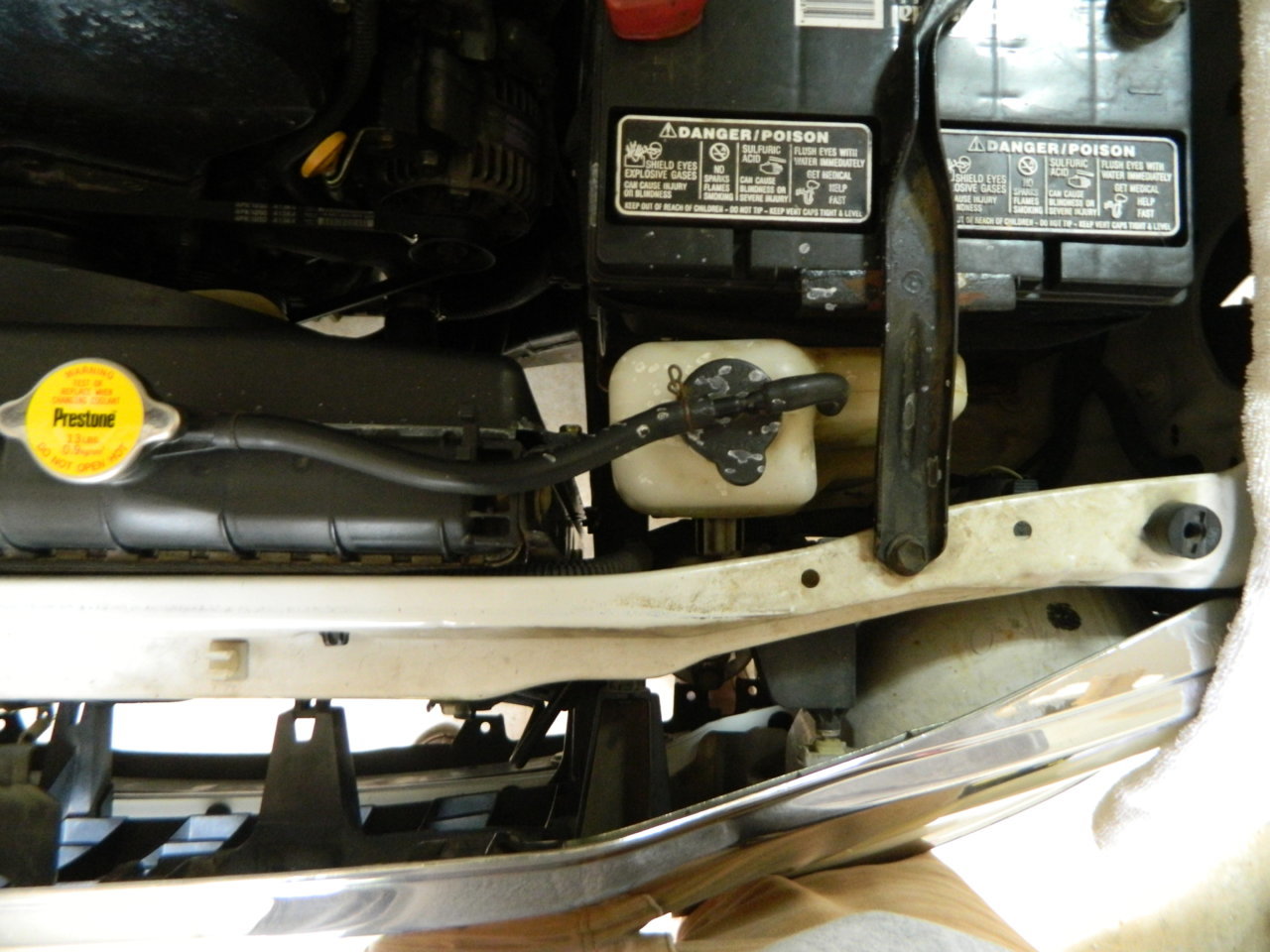

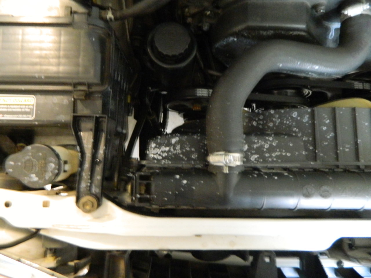

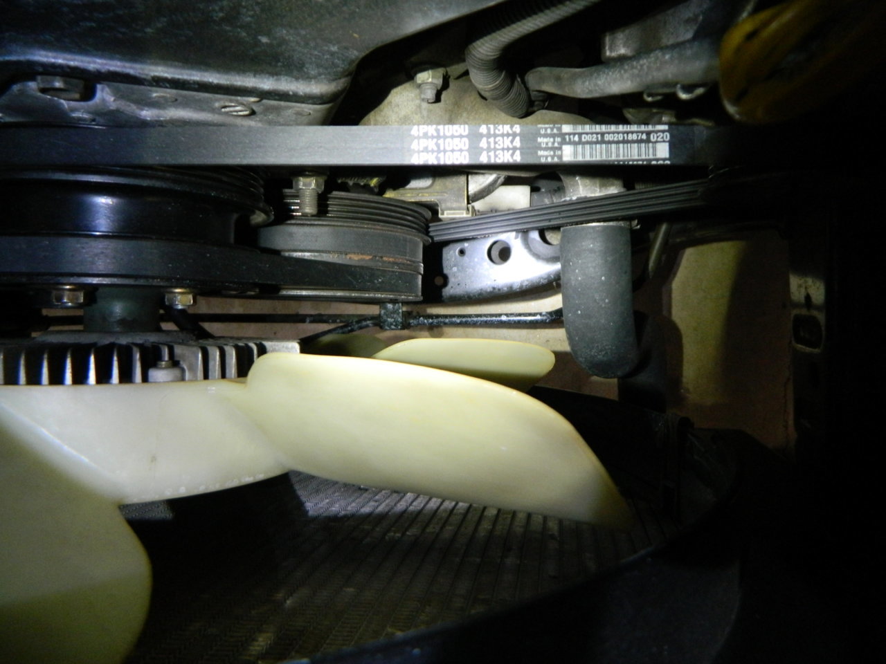

    Right now, I'm losing coolant as depicted in the three pics below, and I cannot find the source. I do have a known tiny seep where the lower radiator hose joins the engine, but that's not this. The overflow reservoir is empty. The radiator fluid level is down slightly, maybe an inch.
    I ran the engine in the garage just now to operating temp, but I couldn't see a leak. Where's this splattering coming from?

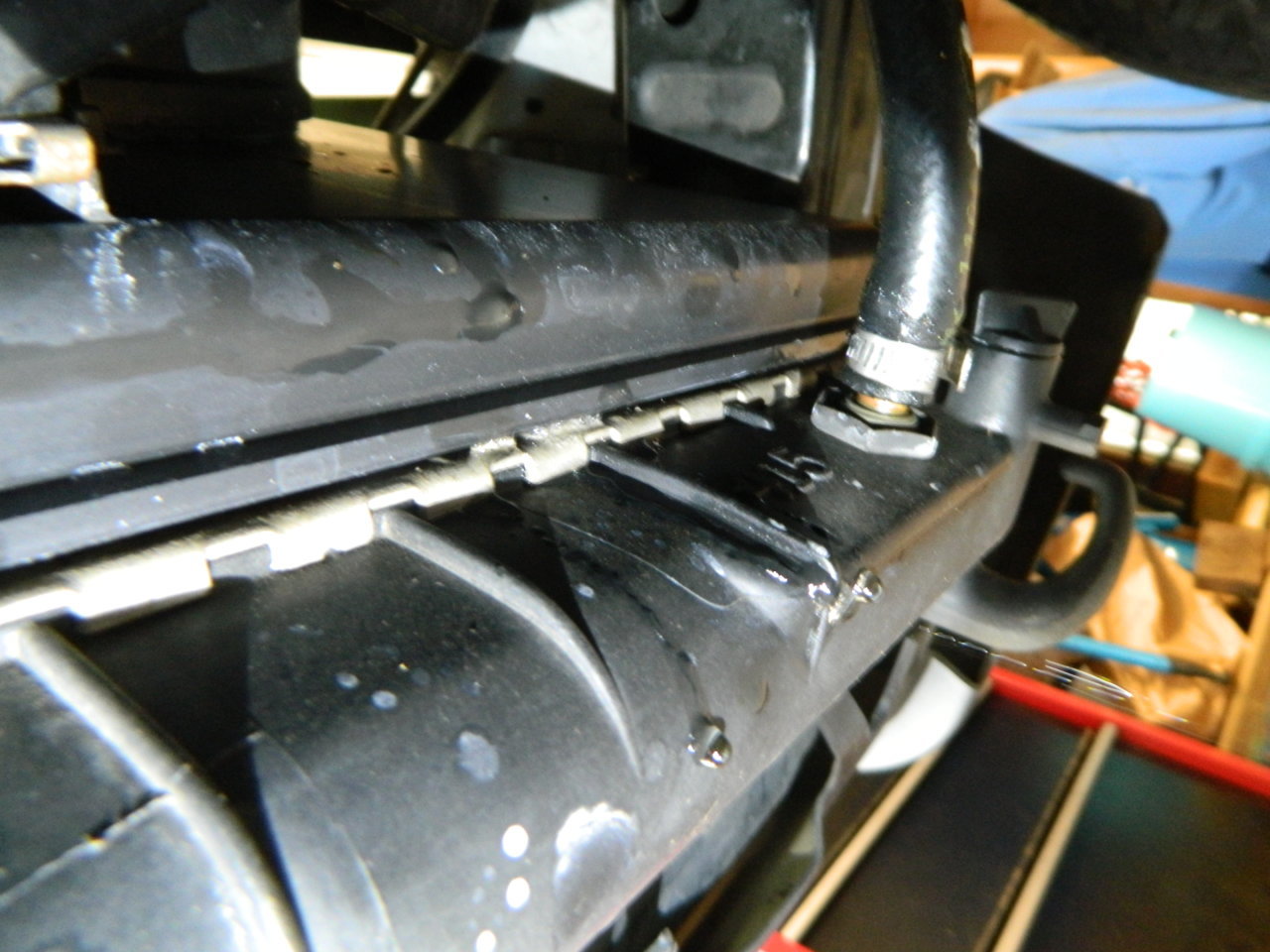

    Okay, AutoZone to the rescue; rented a tester. With 12 PSI, I got it to bubble out the bottom, as pictured below. Bubbles are just left of the hose at right.

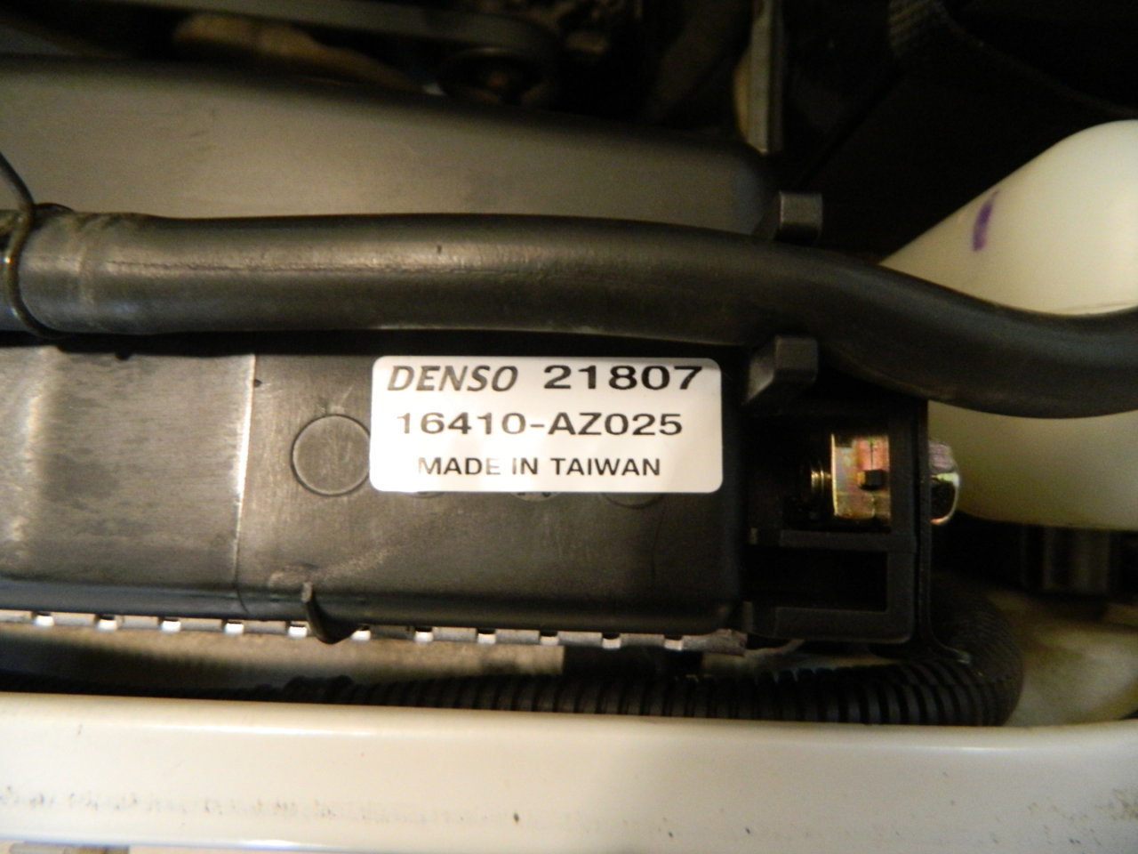

    There's three different radiators. Hang on and let me see if I can find them. What's your truck? Auto or manual?
    Edit: Found it. 18 7/8 is the one Toyota specifies for the 5-lug. The middle height one is for Prerunners and 4x4s with a manual transmission. The tallest one is for Prerunners and 4x4s with the auto.

    Hey thanks. I have the 3.4L 4WD with automatic trans. I got the part number from Toyota Parts of Dallas, but their website said "Item Discontinued", so I plugged the part# into Amazon.com and got it ordered on Prime. (So, I assume I got the right thing...)
  12. Nov 8, 2018 at 11:11 AM
    zach141b
    zach141b [OP] Well-Known Member
    May 11, 2014
    #129576
    398
    Zach
    Louisiana
    2001, double cab, 4WD, 3.4L Tacoma
    I installed this radiator today. No problems so far. I figured I got 17 years from the OEM, so get another OEM...
