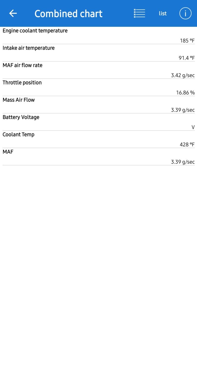

    Hello good afternoon,
    I have a 2013 Toyota Tacoma V6 271,000 MI. My 10th gauge on the dash always stays in the exact same spot it seems to be perfect when I hook a scanner up to it and check those readings it says 185 consistently as I was looking through on the live data I noticed there's another coolant temperature that goes up and down constantly between 100 and 400 back down it's always sporadic should I be concerned? Does anyone know where the two sensors are located?Screenshot_20231110_111435.jpg

    This looks like some Bluetooth or WiFi OBDII device and an android app.
    Tell us exactly what they are.
    In the meantime, I bet it is your transmission or torque converter temperature.
    I think that app is wrong though. If your transmission fluid got up to 400+ degrees, it’d be fried up.

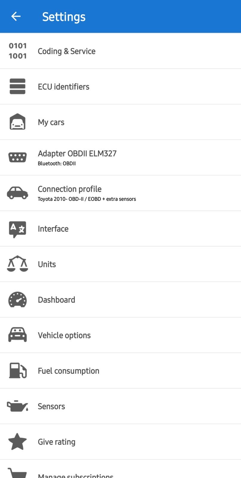

    Engine is warm and I'm sitting in a parking lot truck in park..Screenshot_20231110_125003.jpg Screenshot_20231110_125003.jpg

    Probably a scan tool bug, I wouldn't worry about it. 2nd gens only have 1 coolant temp sensor and they run a 180 degree thermostat so coolant operating temp typically stays around 175-190F

    Idk what the PID is reading from but it's definitely not a temp sensor, the coolant temp sensor isn't even capable of reading anything higher than 284F and it would also set codes if it was changing back and forth that quickly.
