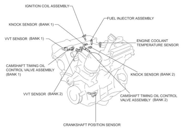

    So where would one insert a probe on a Tacoma for an aftermarket coolant temp sensor? This is actually the only vehicle that I don't have an aftermarket coolant temp gauge because it's my daily driver and I don't really beat on it. Is there a port in the head or block or would you have to use an adapter in a radiator hose?
    I've got one on my Cummins and it's in the water jacket in the head (Cummins has ports everywhere for everything) and my BRZ is in an aftermarket water neck (lets you use a common radiator cap, factory is some oddball thing).

    Just thinking out loud....there are coolant drain plugs on the 4.0 block on either side. The left side being the easiest to access. OrSensors 1GR-FE.jpg
    Probably easier to add a scan or ultra gauge, or obd bluetooth device.

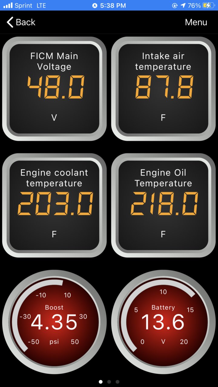

    I've got one of these in a Polaris Ranger. I'd rather have it in the block just from the hassle, but I'm definitely not opposed to these.
    Exactly, I think the analog gauges look more put together than a digital readout and its a rare thing for me to use a digital gauge.
    I work in a chemical plant in a utilities power generation capacity (steam powerhouses and power distribution), analog gauges are typically an improvement because you really gain a lot more info from them at just a glance vs numbers on a digital gauge, plus you can more easily tell rate of change with analog (not that it would matter with oil pressure or temp). In the beginning analog gauges were mainstream, however with the coming of the 7 segment display everything had moved to digital readouts and it required a lot more thought (in some ways thats a good thing), but it was found that things are easier to understand with an analog gauge especially under pressure (stress).
    With a quick glance I can tell pressure or temp is within an OK range without knowing the actual value just from seeing the needle is in the "right" area. People use a speedometer that way, you know were 55 is and aren't really looking at the numbers but just making sure the needle is right in the normal zone.
