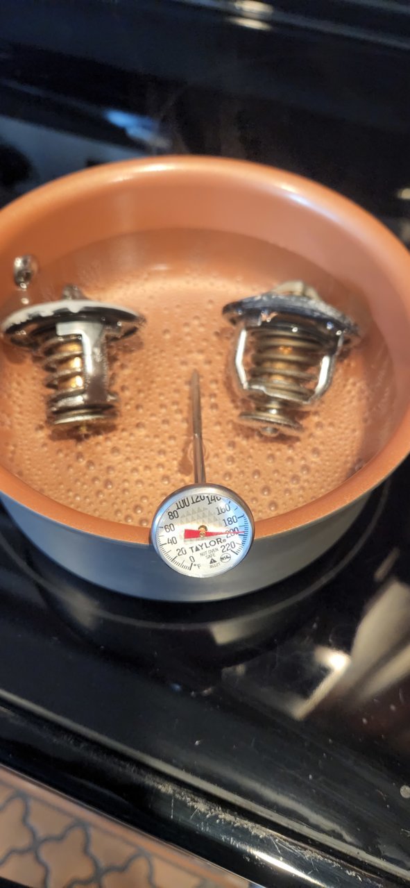

    That 30 degree change sounds like it was in the correct direction. You want to be up around 190-200. That's not like a "danger zone" or anything. I'm going to guess the temp gauge needle never leaves the 12 o'clock position?
    All its going to do is get you a little better gas mileage

    Thanks for the replies. I pulled the thermostat and tested it in hot water. It starts to open in the 190 range and is fully open at 200 degrees whereas the old one opens closer to 170.
    I am going to install it with the jiggler faced down and see if there is a running temp difference. Old one on the right

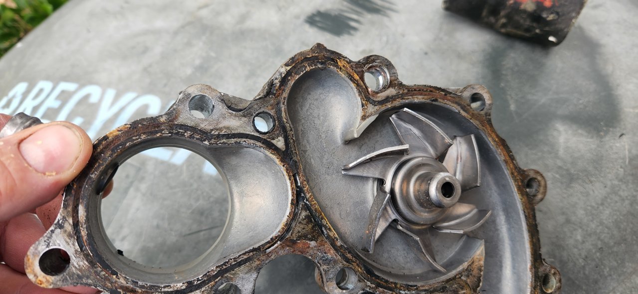

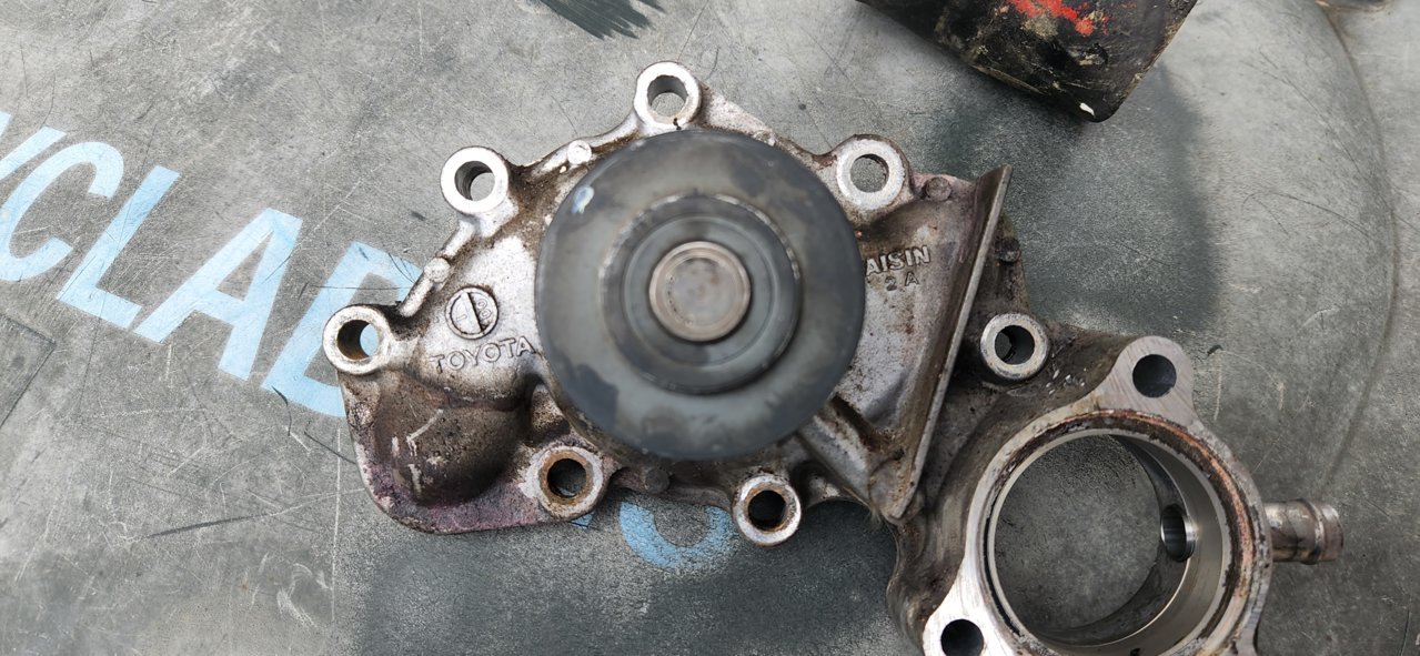

    I have had the truck for 3 years. Bought the parts for this job 3 years ago and have been meaning to change the timing belt/ water pump since then. I had been noticing a slight coolant smell for the past month and decided to do it over the weekend.
    I figured the belt/ pump had never been changed since it only had 70ish k miles when I bought it but the old pump appears to be after market even though the pump was embossed with Toyota and aisin. The pump had a recessed Grove for an o ring or sealant versus flat and a metal gasket with the new one. The old pump was leaking.
    I just flipped the thermostat and it's hovering at 188 degrees, ten degrees cooler than before. I am still wondering how the jiggler at the bottom makes a ten degree difference but it appears to.
    I will include picks of the old pump. It's it a counterfeit oe pump?
