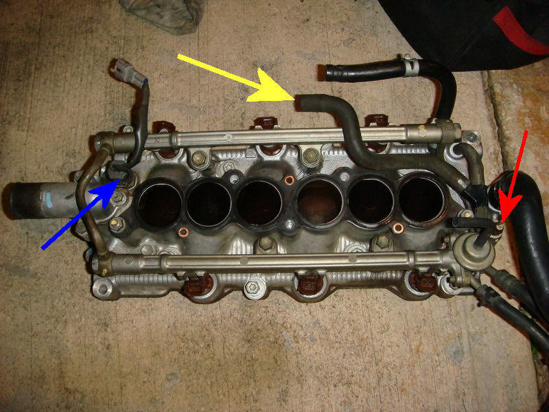

    The sender for the dash gauge is on the rear of the lower intake manifold, red arrow.
    The "engine coolant temperature" used only for engine management is at the front, blue arrow.

    Thanks "Dirty Pool". I figured a setup as you pointed out. My incorrect Haynes manual showed a single sensor on the lower intake, halfway between front and rear. I probably would have never found it since it's covered by a plastic case. Sensors, yuck. I miss the old days... 8 plug wires, 1 fuel line and 500HP.
