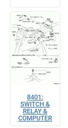

  8. Jul 3, 2021 at 7:18 AM
    Wsidr1
    Wsidr1 Well-Known Member
    Jul 11, 2018
    #259004
    3,080
    Indiana
    2 x 95.5 Ext 2.7L & 3.4L A/T 4x4
  9. Jul 3, 2021 at 8:18 AM
    1943MB
    1943MB [OP] Well-Known Member
    Apr 13, 2021
    #362621
    125
    Louis
    1999 Tacoma Regular Cab 2.4 litre
    none
    Wow ! this is great, thank you so much !!
