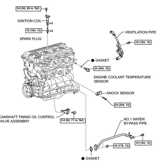

    Hello
    Ineed location wire coolant temp to drum (gauge) hilux 2013 2TR-FR

    Sensor location
    That's about all I can find
