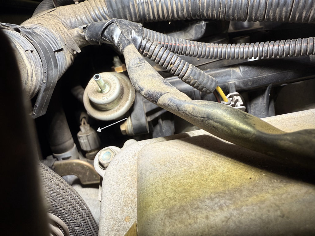

    It is on the back of the engine on the coolant manifold, it's not in an easy to see spot.
    They don't fail very often, what kind of issue are you having?
    This is the best picture I could get of it, this is looking from the passenger side under the main engine harness.

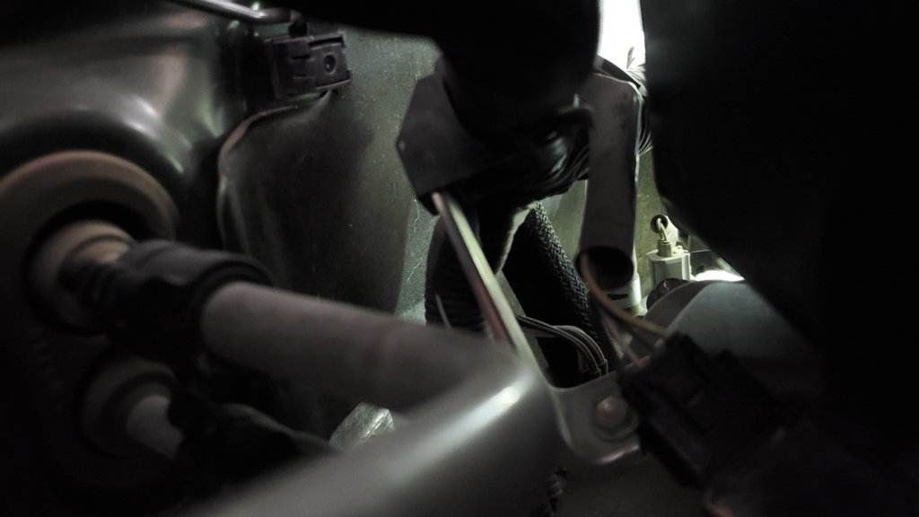

    Okay, I think I have found it. Can anyone confirm? Thanks

    That's it.

    I think that is what I'm looking at from the other side.
