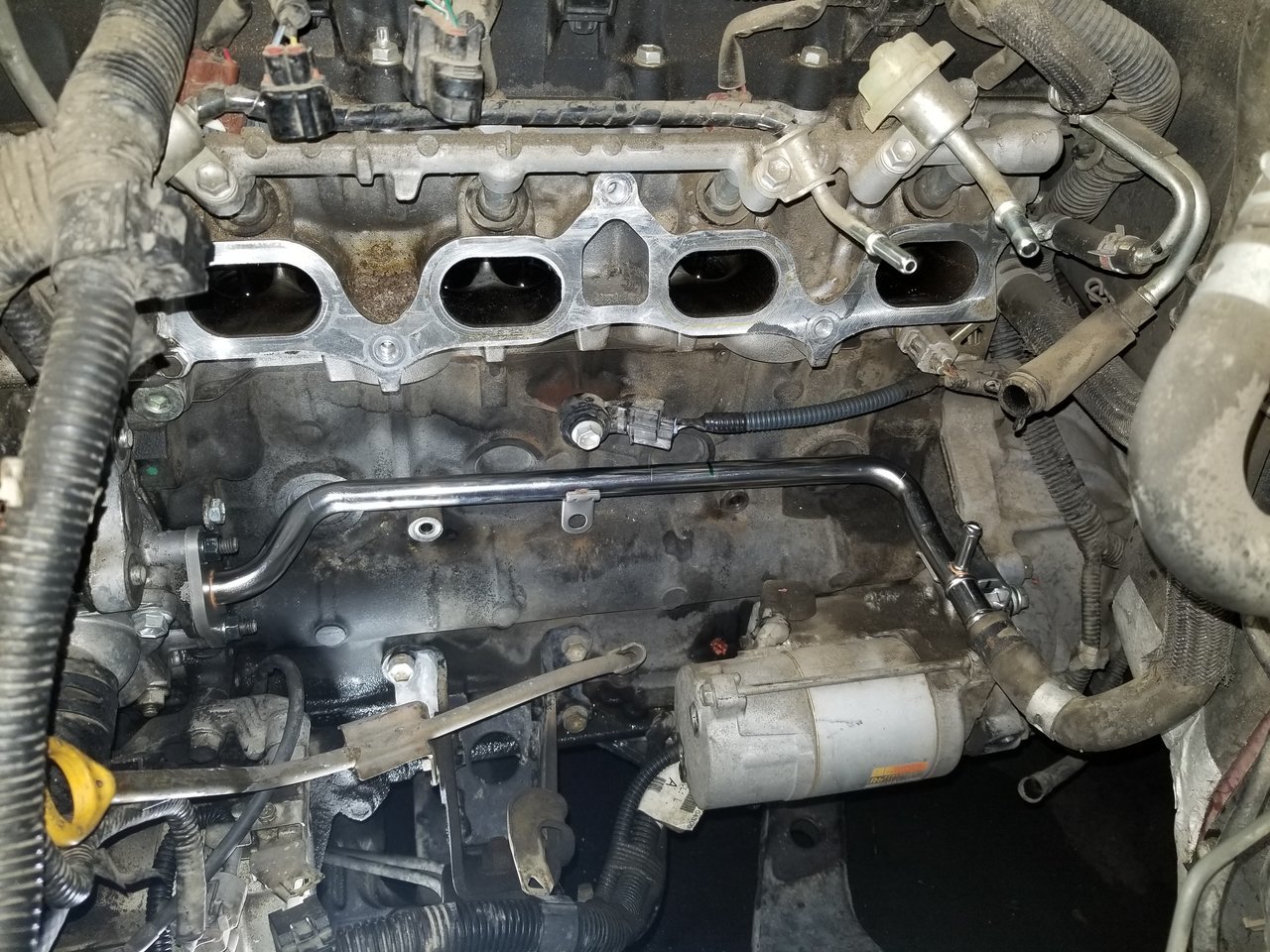

    if you have nt done it i would
    replaced mine.

    Upgrade or just replace?

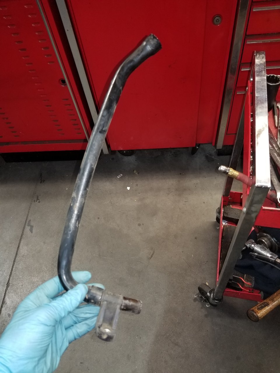

    replaced thats new oem one which is way better then the old one

    Before 09 or so, the coolant bypass was plastic and it's knows to fail where it bolts to the back of the thermostat housing. After 09, it was switched to metal. There's no functional difference, just a change to better materials.

    Easy swap? How much coolant do you lose? Something that can be done on the trail with a toolkit? I don't particularly want to do it but I'll gladly buy one and keep it in the truck as a spare.

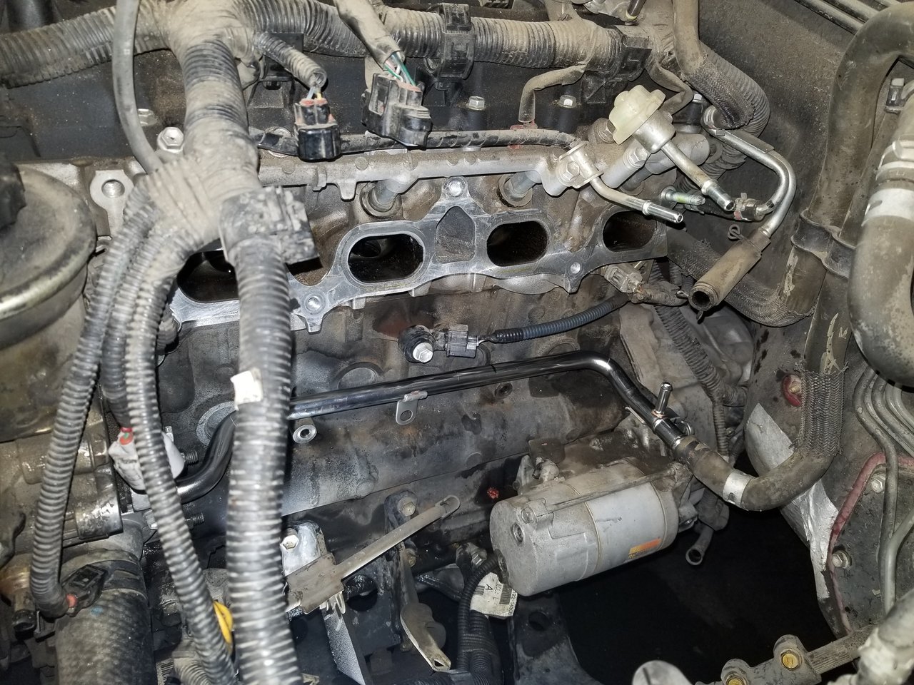

    need to remove the - clamp on the battery then take out the throttle body and intake manifold off (going to need to move some wires) the 3 hoses by the firewall the one small one is a big bitch to take out and put back in, i also take out the tranny dip stick plus remove the starter and you should be good (you going to need 2 things of coolant to fill the truck) it took me about 3 hours to do and that with a lift

    i would nt wait for it to bake off and leak coolant every where
    my friends shop will do it for $200 that if you dont want to do it your self

    Mine is a 2010 and I'm 99% sure mines plastic.

    Hi I don't mean to ask a dumb question but I have an 05 Tacoma and my truck has this same leak at the coolant water pipe and I am having the frame replaced in the coming weeks. With the motor out when they replace the frame how much easier would it be to replace this? Thanks

    Probably really easy with the motor out. The parts for it are less than $100

    I overheated my truck and it cracked and had a slow leak there. Some might break all at once but I think most leak for a while

    Someone posted that that 2010+ was stainless. Mines plastic and it’s early 2010. So it must have been a mid year switch?
