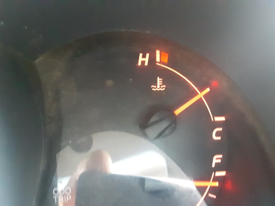

    gauge.jpg For 4.0 V - 6. Has anyone notice how long the engine takes to go from "stone cold" to its designed operating temperature? I know there is a lot of variable factors to consider i.e., ambient temperature, thermostat rating, general condition and age of cooling system components. Thanks in advance.

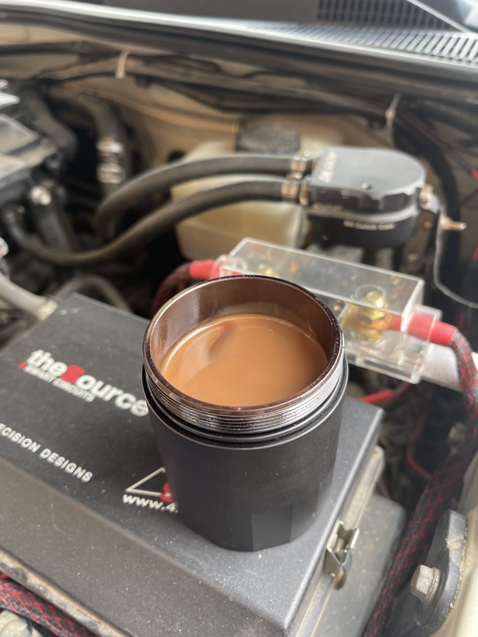

    If you have short cold trips you can add a catch can. A $30 one has a dipstick, requires manual emptying when you do an oil change, and runs the risk of appearing “modified” during a smog check.
    or for $300+ you can get fancy with a Mann ProVent 200 that has a replaceable swirl filter, and add a one way drain back valve/hose to send any oil caught back into the engine, so there is no oil to empty out every change.

    I had the forbidden latte this past winter.. Catch can got it all

    The Tacoma temperature gauge is worthless. It tells you the engine is on. It stays in the same spot from 180°F to over 200°.
    Get an OBDII transmitter and app.
