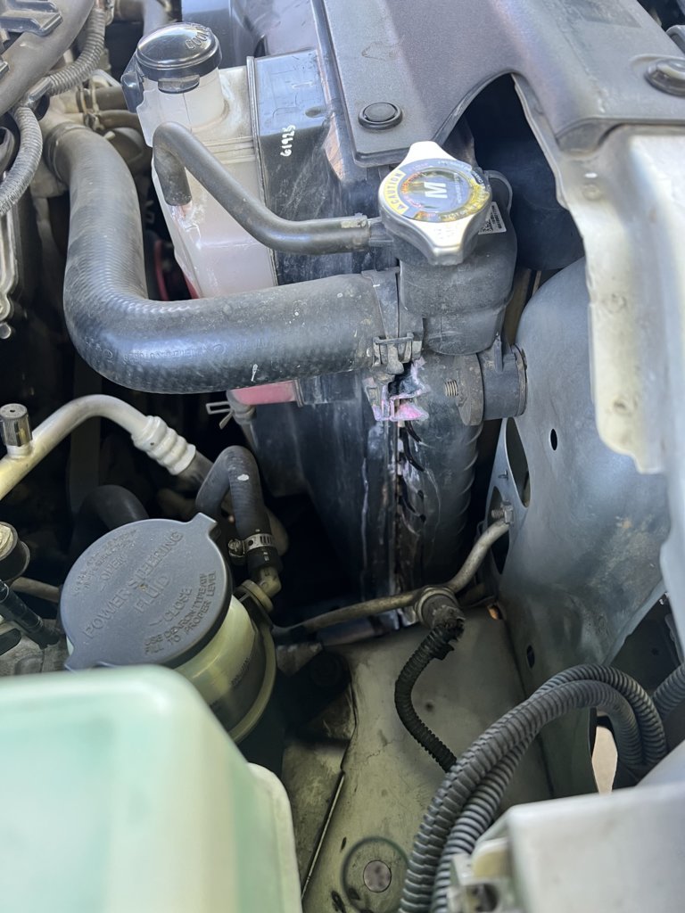

    So, I looked under the hood and saw this:
    Is the radiator failing?

    Res. Looks low
    Possible leak
    Possible heater core leak
    Look for leaks
    Under too

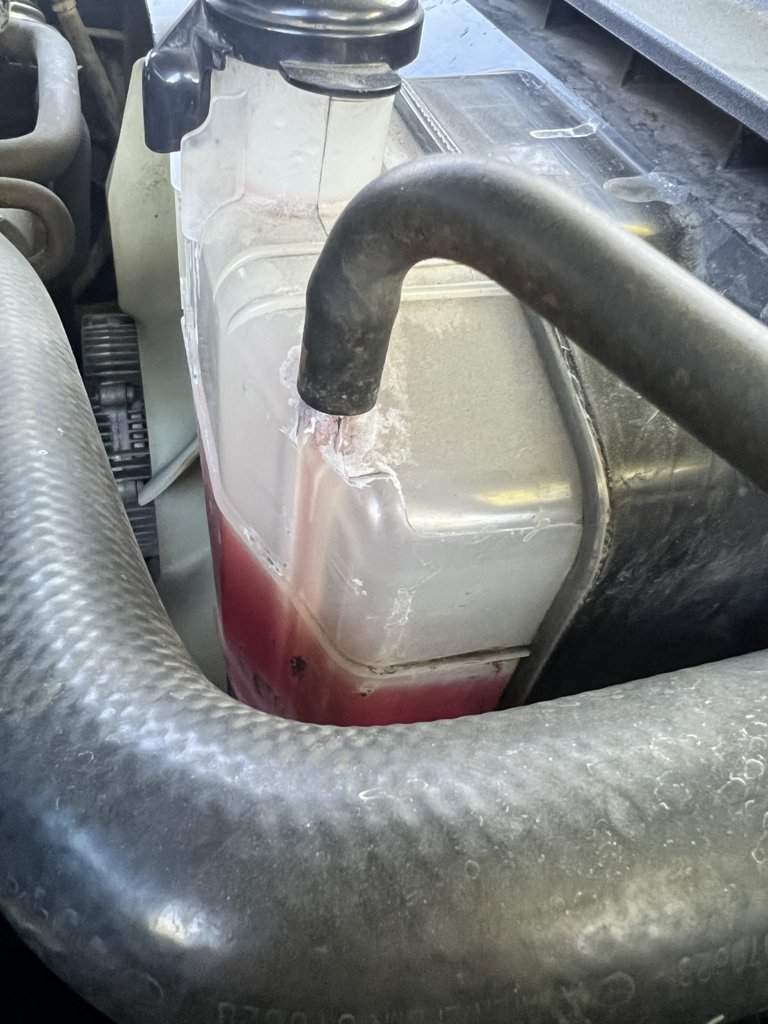

    reservoir isn’t too low…

    To me, looks like the radiator or the hose clamp. Rotate the clamp or replace it, then pressure test the cooling system to check for any leaks.

    Needs to be diagnosed correct to know precisely what is leaking.....
    Actual clean off & pressure test until youre able to isolate the source of the leak, sometimes could take hours under pressure or specific temp if the leak is small.
    could be radiator at the tank to core pinch requiring a radiator,
    could be hose to radiator connection
    I would even inspect the recovery tank & related hoses well....
    That being said, YOU DO HAVE A LEAK!!!!

    If you want to roll the dice as doesnt seem to be a severe leak....
    Go get a worm style upper radiator hose clamp & replace the upper hose clamp at the radiator.
    Clean off all the pink residue with a detergent / cleaner of some sort.
    Dry the area off, & monitor for a few weeks or until / if you see wetness & stain again.
    If you do, radiator....

    The coolant level isnt low, so you'll likely be fine
    Just try moving the hose clamp to different position, like slightly farther away from the radiator where the rubber is more thick and pliable. Or cut off a half inch and reposition the clamp. It's quick and won't cost anything

    Could be a few different things plastic radiator tank could be cracked radiator hose and clamp can cause This ,clean it off and try to see where it’s coming from.
