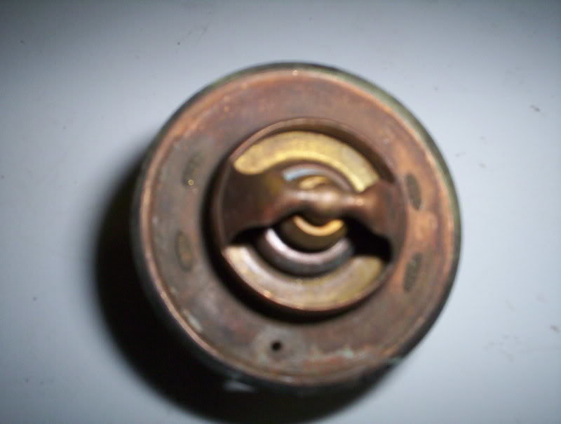

    Drill a bleed port thru the thermostat washer area that touches water. 1/8" drill bit should do the trick if you have the room. I do this to every new thermostat on every vehicle I own to remove blocked air bubbles/purge the system when refilling. With the drilled hole, as you refill, it should force the bubbles to the soft side of the system as the water rises in the block. The small 1/8" hole wont affect cooling per say and you will always have a small amount of flow weather the thermo is open or closed to remove that trapped air that might build up.

    The engine didn't get bored when it was rebuilt. I'm willing to drill the hole, do you have a picture on one you drilled?

    Not mine, but a similar situation of drilling a hole in the t-stat for purging air out. You want to get inboard enough to where the coolant is touching that flange and will allow the air to seep out as the coolant level rises during filling.

    just wanted to share with you guys that drilling the hole fixed it. Seemed to be the only way I could purge out all the air. Thanks for the info.
