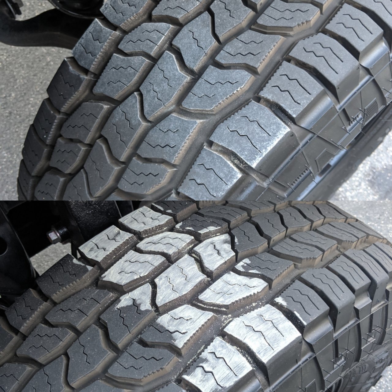

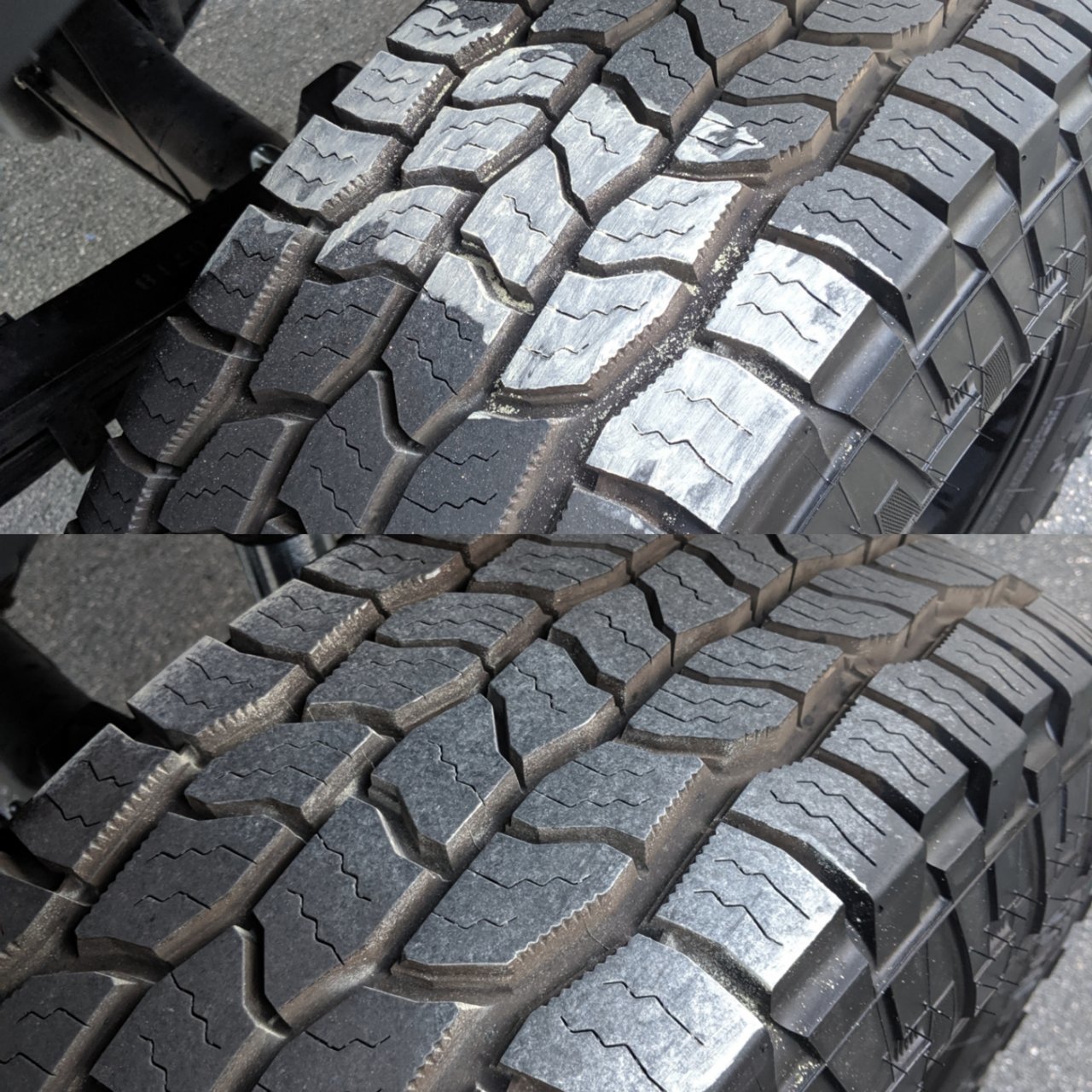

    This is 30 front warm chalk test
    Rear landed at 28, still could go down a little, but I'll leave them a little over.

    Wow, the ride is a lot better after dialing in from chalk test. Wish I didn't wait so long before. A couple psi makes a huge difference.

    I can definitely see the tire wear spreading to the edges of the blocks now and it's all wearing. So I guess 30F/28R (warm) ~ 28F/26R (cold) is a good place to be with 285/75R16 ATR3 XLT on 8" wheels. I'll have to be a little more vigilant in colder months to keep pressures right.
    Based on the charts and my calculations of the tires capacity at those PSIs, that still covers GVWR (5600lb) and then some; I never tow. Worst case, 28psi cold is around ~1850 load capacity per tire and 26psi cold is around 1750lb (TRA Light Truck Inflation Table chart). Collectively that's still 30% over GVWR cold.
