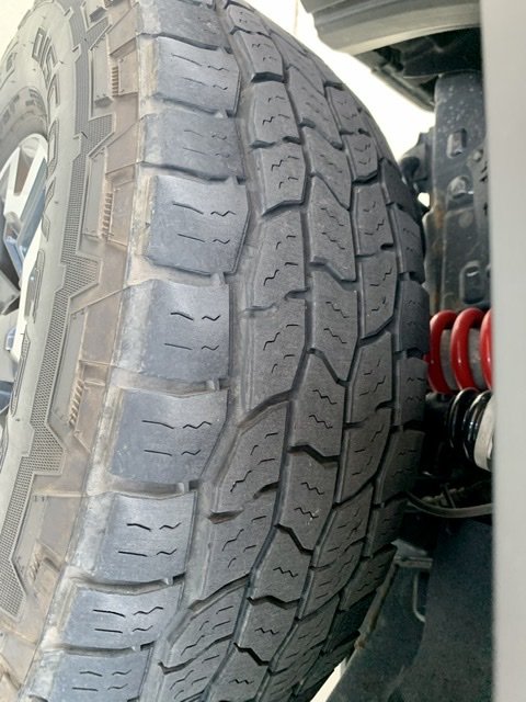

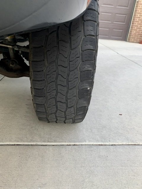

    I will preface by saying I really like these tires and will probably get another set when the time comes but after almost 20k miles I'm starting to notice some strange wear patterns on the inside/outside tread knobs on all of the tires. There is more tread one side of each knob than the other. I rotate them regularly and run 34-35 psi in them cold (265/75R16 LT C load). Am I running the wrong pressure or is this common for these tires? TIA!

    I noticed it as well, I do cross rotations and check alignment every 6 months. It's just the nature of the tread.
    Do you rotate side to side? It reverses the tread direction and helps promote better wear.

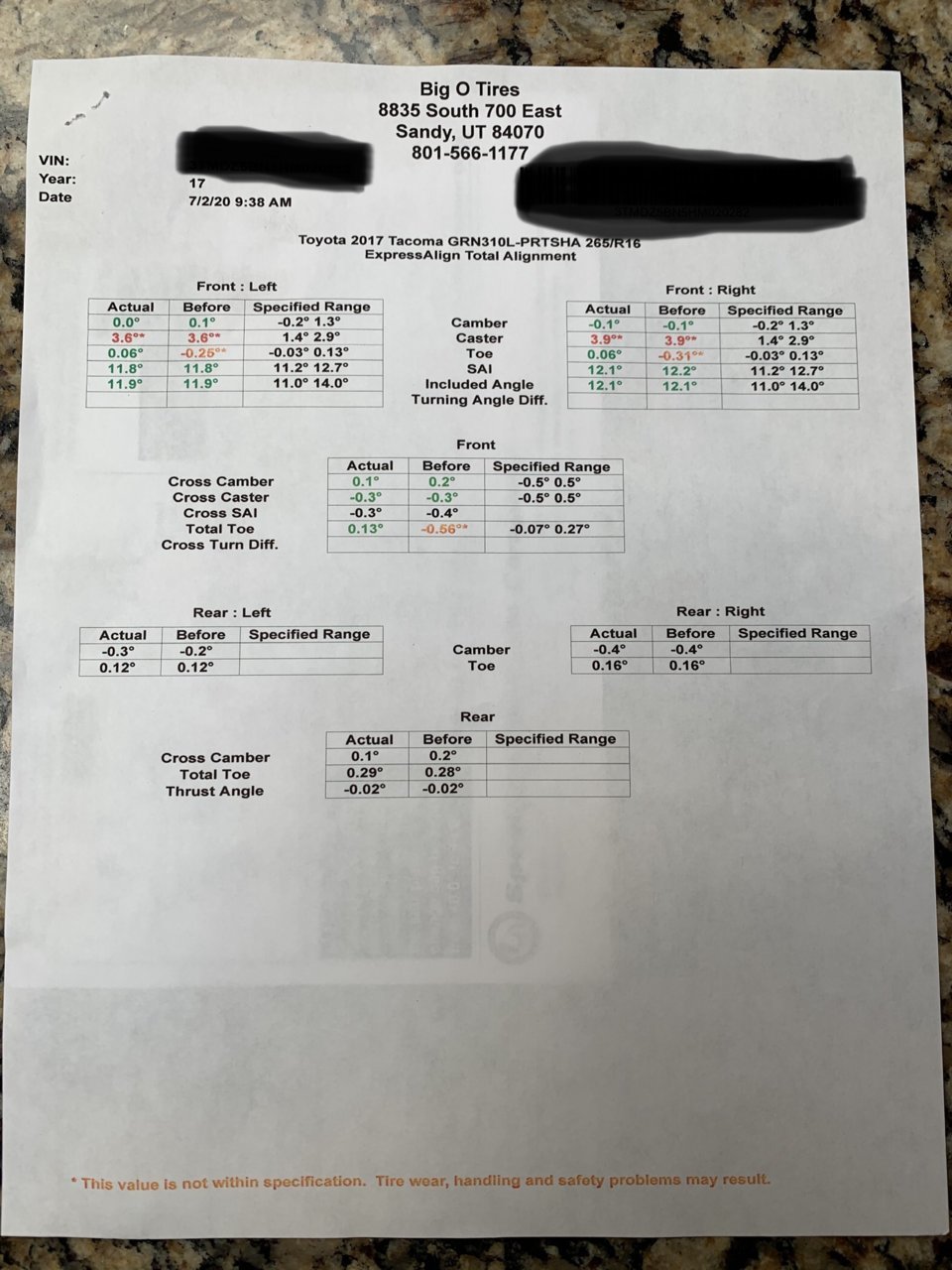

    I have this also. At ~40K miles on 265/75/R16 C-load tires, been getting the strange half knob wear on outer shoulder knobs. I rotate every 5K miles myself, fronts cross and go to rear, rears come straight forward. Also thought it was alignment but have had 2 alignments and installed SPC’s to further dial in alignment and the wear patterns has continued. It’s not terrible, but it makes for a little more noise as they wear.
    Added a few photos and my latest alignment for reference. Only reason tie was out was because I put on the SPC’s before that alignment. It was good before that.

    More than two times the total -toe than spec. Reduce caster and get the toe into spec.

    You talking about my alignment actual/after Alignment numbers? 0.06 on each and total of 0.13 seems to be right in the middle of the ranges specified.
    I didn’t drive more than 7 miles on the before numbers. That was only after I installed new UCA’s. Before UCA install, alignment was the same as actual only with 1.9 and 1.6 caster. Toe got thrown off with new UCA.

    Caster is good, balanced is all that matters.
    Toe 0.06 I actually like it higher on trucks. Nothing wrong.

    Yes, I should have been more specific. The before toe numbers were a major contributor to the scuffing. I still would have reduced caster. If you drive primarily freeway it will be fine. High caster numbers will increase steering effort.

    Yeah, I wasn’t driving around for 5k+ miles on those before #’s. I installed UCA’s and drove ~7 miles to alignment on the before numbers.
    I need to dig out my previous alignment sheet but it was the same as actual shown above just with lower caster. I drove on that alignment for ~15K miles. I’ve had 3 alignments attempt to address the wear and finally bought UCA’s to see if that was it. My point is I find it unlikely my previous alignment (before UCA install) contributed to the wear pattern. I think if others are seeing it also, it has to do with tread pattern. Wondering with the wear bars stiffen one area allowing it not to deform like the other part of the tread block?

    I
    I would stick with alignment being the issue. Tread may just be more susceptible to a bad alignment. Once the wear is there it is there. Fixing alignment won't correct the wear.

    Got it. Definitely been chasing this for the last 20k on these tires. But if it’s true once you get the funny wear there is no way to wear them back into shape, then it’s possible an early alignment issue caused this.
