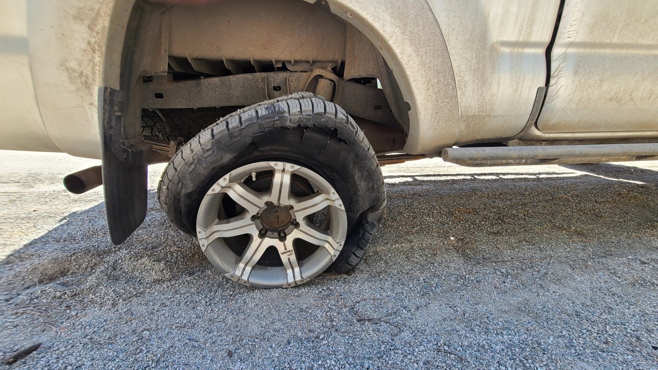

    I got 5x of these AT3 S4s in 285/70R17 in October. Now, in 7200 miles of mostly city or highway driving, 2 of them have exploded. My old ST Maxx tires lasted forever with 0 issues. Having 2 blowouts without hitting any road hazards has me thinking either I got a defective batch of tires, these aren't heavy duty enough for my truck with steel bumpers, sliders, and a roof rack, or there is something wrong with my truck?
    First one was front passenger side back in November while driving 65mph on the highway. This most recent one was on my rear passenger side while driving at 50mph up a mountain pass.
    I've been talking to Cooper customer service and they just said talk to the dealer (tirerack). But honestly I would feel better about figuring out what is going on. Would a reputable tire shop be able to look into any issues? I don't know what it could be. Alignment feels good. I had just rotated the tires a week or two ago and filled up to 38PSI in front and 40PSI in back before I left on my last trip.

    Most likely too much PSI maybe overloaded? Only 285/70r17 for the AT3 4s is listed as a P-Metric in Standard Load. Your likely overinflating the tires which caused them to blowout. Rated for 35 PSI max, if you filled them to 38/40 (cold) and rolled down the highway for 5 miles your probably at near 42-43 PSI per tire. I'm not an expert but just throwing out an opinion.

    That's weird because when I looked them up it said 36-44PSI

    Any close up pics of the blown tires? What does the date stamp say?

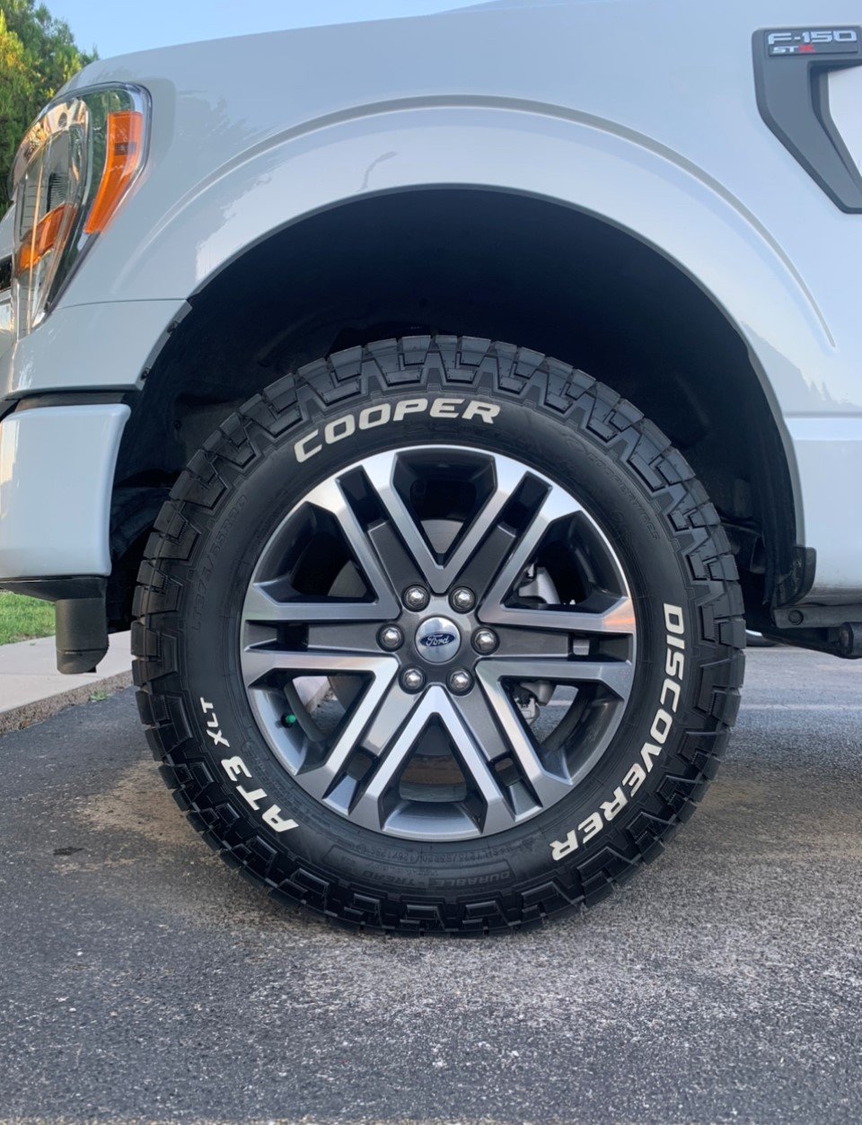

    Thats weird. Mine have the solid white letters. Wonder what the difference is?
    LT275/65-20 Load Range E

    i think that's XLT v. LT or 4S. i have the LT E range and the white letters are outlines.

    Ahh ok. That makes sense. Mine seem to have a little more sidewall tread too but its probably due them being 34.6 in tall with 20 in wheels.

    the extra sidewall tread is the XLT design. it's a bit more than the LT. which is a bit more than the 4S. :)
