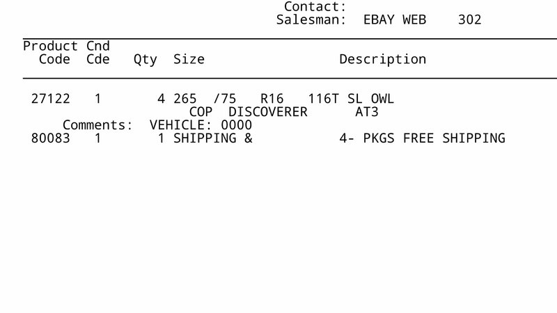

    Here I found my invoice slip and they are 116T rated!

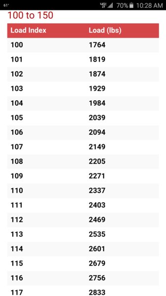

    Here is what the 116T is rated for and it's alot more than Standard Load!!

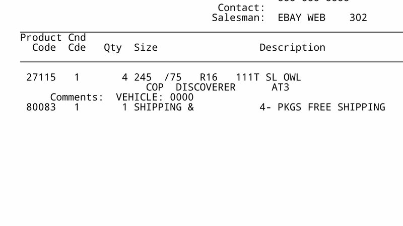

    Here is the standard size tire for the truck in a 245 75 16 which has a load range of 111T! Which is only rated at 2403 lbs so about 300 lbs less!

    That's a standard load (P rated) tire, not an LT "C" rated tire. It likely still has "4 ply's"

    On Cooper's web site the "P" 265/75R16 116T "STD" is rated at a listed 2756 lbs and the LT265/75R16 112/109R "C" has a rating of 2470 lbs. I was reading on the Tire Rack web site on tire ratings where they state that LT tires are derated according to government regulations to a lesser rating capacity in pounds because trucks stand a good chance of being overloaded beyond the rating where as passenger tires because of the "car" configuration usually cannot be overloaded.
    I might assume that because of this derating in listed weight the two tires may be the same construction?

    I was simply pointing out he's got passenger tires with less "plys"/thinner sidewalls than an LT tire.
