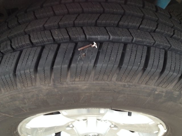

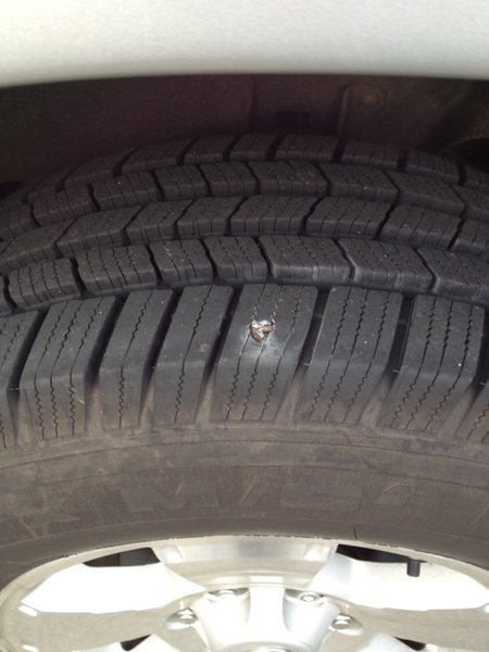

    LT tires have thicker sidewalls than P rated tires. Load C, D and E have increasingly stronger carcasses at the tread/contact part of the tire and thus, are more resistant. Load rating has to do with strength so it can handle more air and more weight.... but those characteristics also make it more resistant to puncture. Think this screw wouldn't have gone through a P rated tire?
