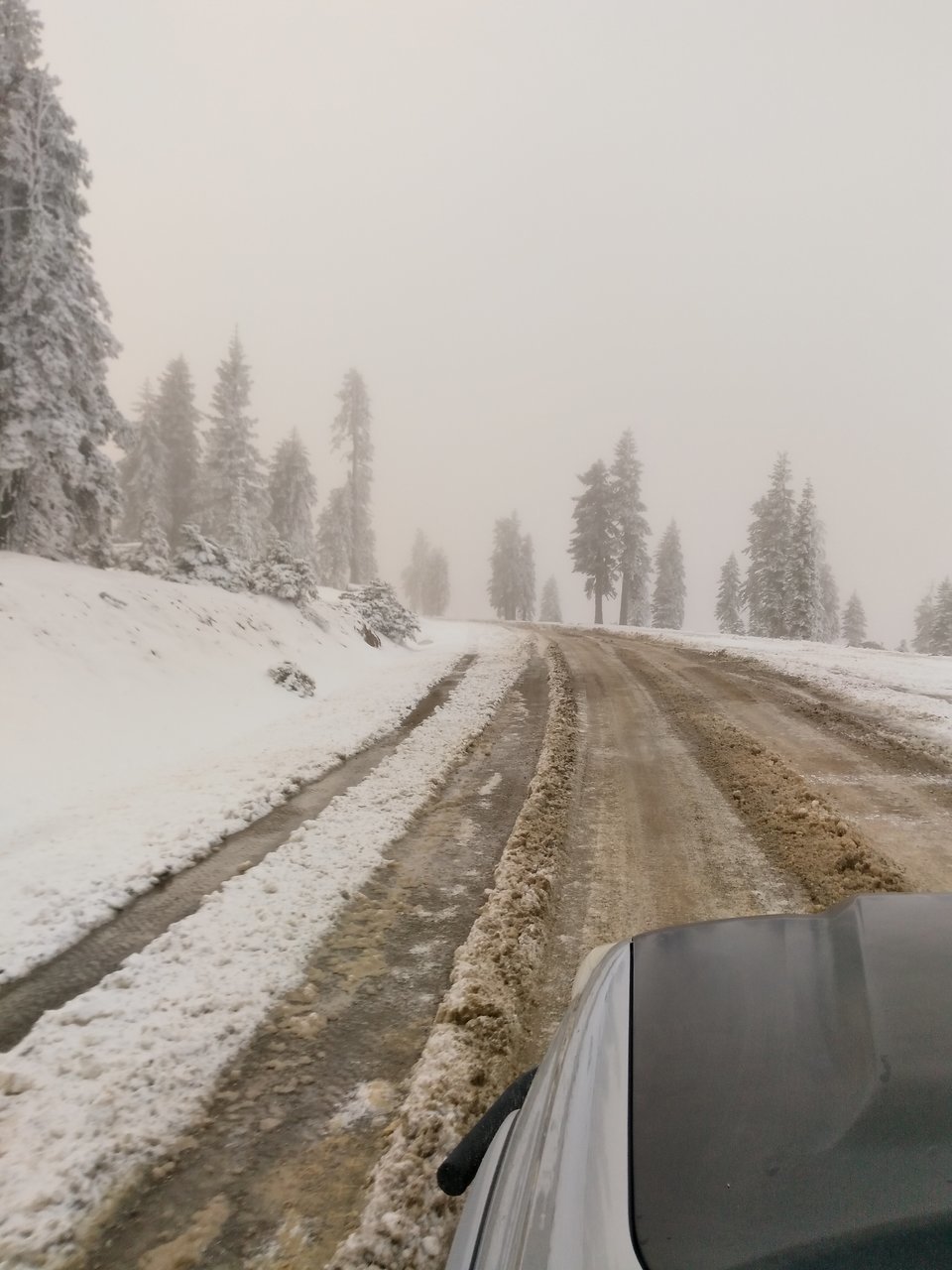

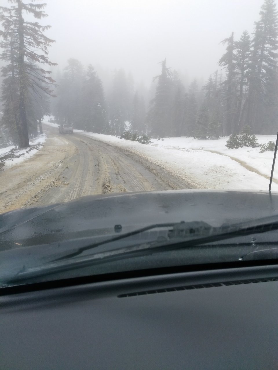

    IMG_20171021_132336.jpg IMG_20171021_075815.jpg I was surprised how well my locker engaged Prerunner with 285 70 17 AT3 perform in slick snow.

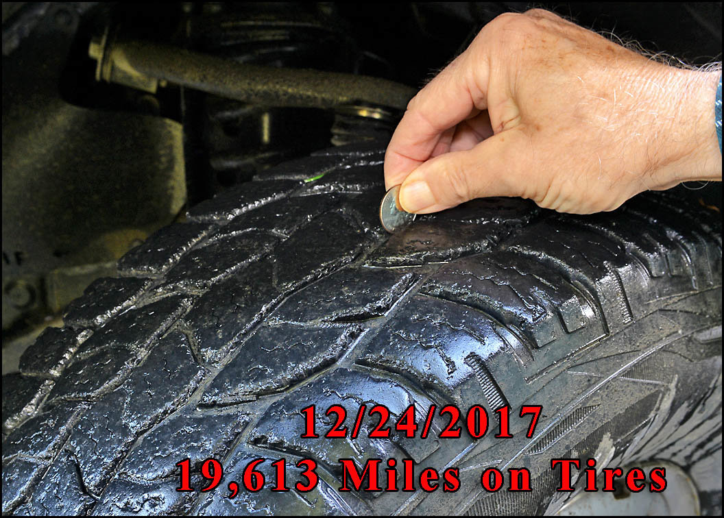

    I had some Standard Load AT3's that I just got rid of. I would say that 85% of my driving is on logging roads. After 20k miles, much of the tread was gone and I was sick of fixing flats, so I got rid of them. If I never left the pavement, they would probably still have plenty of tread left, but if you’re off the pavement very much, just stay away from the Standard Load AT3's. Below is a recent photo at just under 20k miles.
