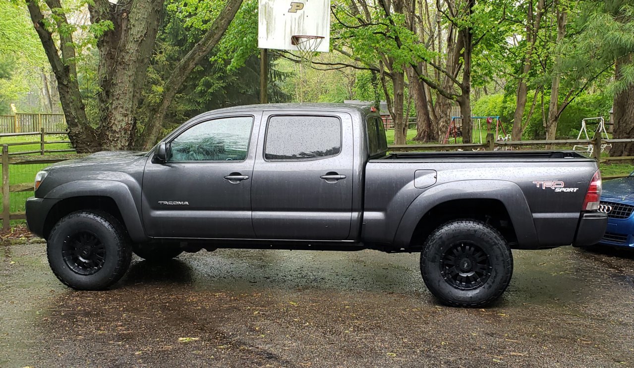

    TRDSport17North
    TRDSport17North 06SR5,17TRDSport,22TRDSport
    Jul 14, 2011
    #59880
    346
    Al
    Ontario Canada
    22 TRD Sport D/C L/B Premium
    Oem LEDs Heads and Fogs, Interior and exterior LED's, Tonneau Cover, Tint, Running Boards, decals overlays and inserts, Bed mat and lighting, Mats, Speaker upgrade, amp, powered sub, Dsp. Meso Stage 1 tails. Complete front end Expel paint protection, ceramic coated, rust protection, 265 70 17 Cooper at3 4s on 17" OEM Sema Pro wheels. More to come...
    Are those 17x7 4mm offset sema's with 265 65 17 tires? My tire guy said I needed to move up to 265 70 17 for the 7" rim. Hope they don't rub on my 22 sport im getting.

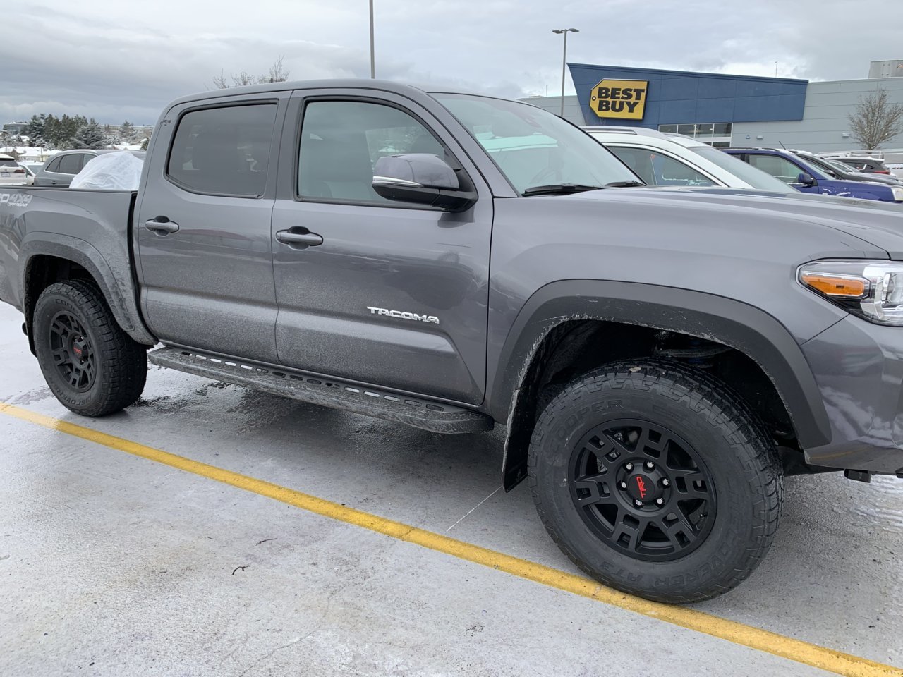

    Silva1181
    Silva1181 Well-Known Member
    Jan 15, 2022
    #387414
    49
    Marc
    Houston
    2013 Tacoma Double Cab, 2.7L, Silver Streak Mica
    Thanks. I have no idea what the off set is of the XD rims are. I checked the XD website but did not see the exact rim most likely because it's an old style. Probably best to stick with 265/70/16 tire size.
    I appreciate the response.

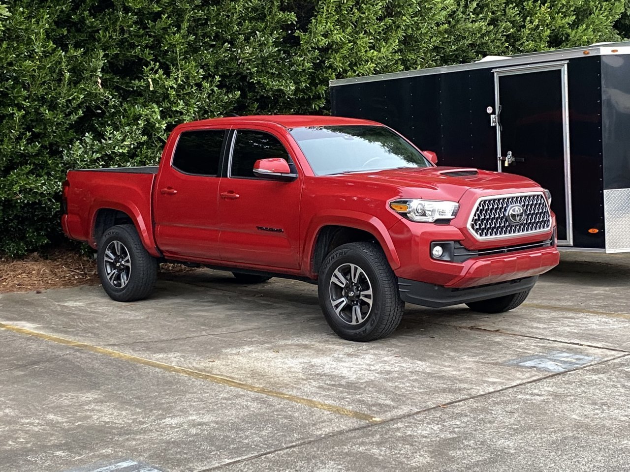

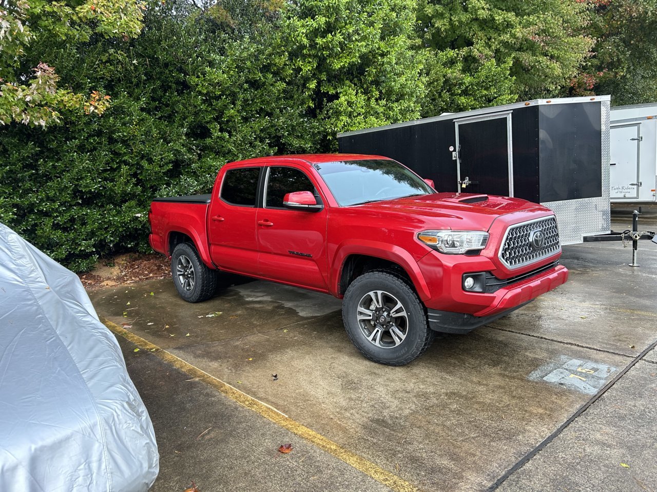

    sweatytaco69
    sweatytaco69 Well-Known Member
    Jul 18, 2022
    #401631
    60
    2019 Red TRD Sport
    Just threw some on my baby. Went up a size to 265/70/R17. What a difference! Pics don’t do them justice. These tires look sharp in person. If you’re on the fence about these. Get em!
    First photo is original tires for comparison.
    07 sport 4x4 likes this.

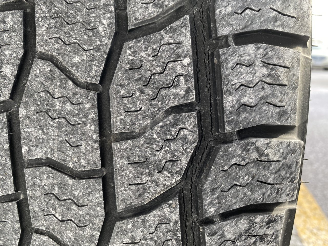

    usmc2msu
    usmc2msu Well-Known Member
    Apr 10, 2020
    #324315
    680
    TJ
    2017 SR5
    Only posting on this older thread because it seems to be the most active regarding these tires.
    I’ve got 36k on this set and they’ve got about 4/32 on them and are hydroplaning like crazy. I don’t drive fast or hard and only use them on gravel roads. No real off-roading. Have done rotations every 6k. These are the worst wearing tires I’ve ever owned. They were really nice until about 30k miles and I started to get slippage on wet pavement. Going with the Yokohama Geolandar A/Ts soon.
