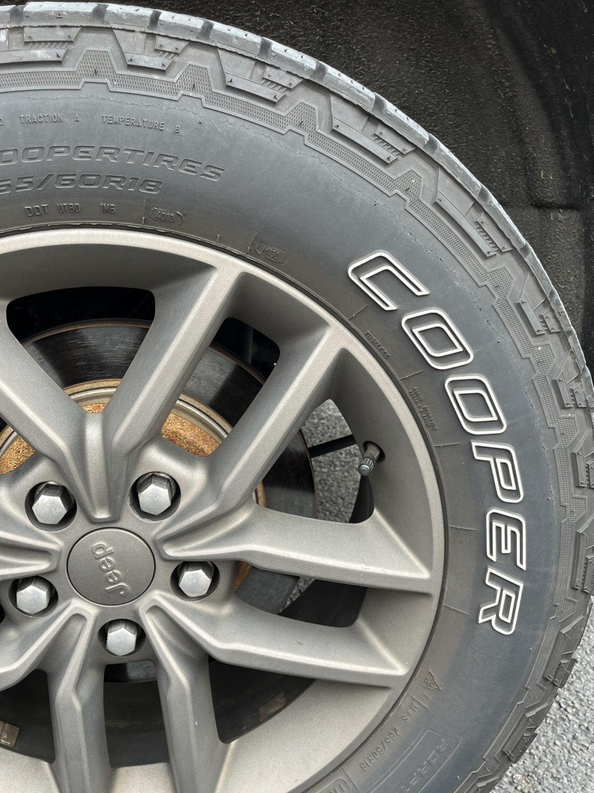

    I had the P-rated AT3 4S on my wife's Jeep Grand Cherokee in 18" Tacoma sizing.
    I only got 50% life out of the set before one tire started having severe cracking / rot on the sidewalls. These tires had even treadwear and were always properly inflated and rotated. Cooper was willing to pro-rate one tire, but given the Jeep is an auto-4WD vehicle I wasn't about to have one tire with a different tread depth, so I opted to replace them with a different brand of tire.
    I was a big fan of these tires until this happened, but I'm hesitant to chalk this up to a single fault as I saw evidence of this starting with other tires.

    My last set of 4S tires started cracking too. I think mine had to do with lots of heat cycles since I put on 85k miles in less than 3 years on them.
