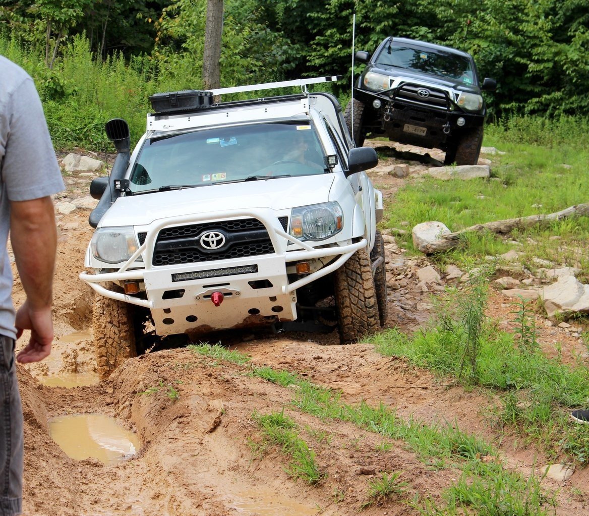

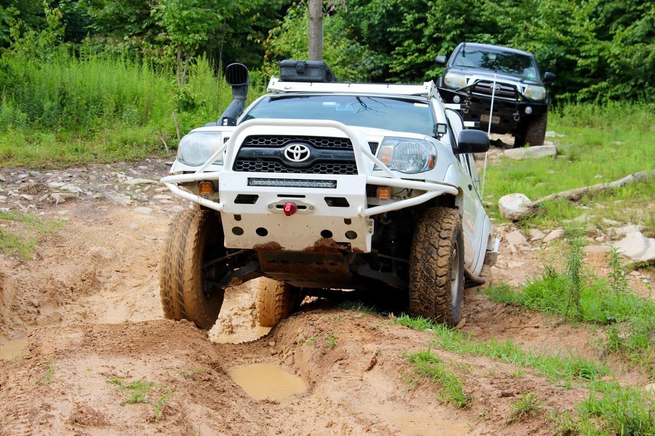

    Relevant, but not 3rd gen. :thumbsup:
